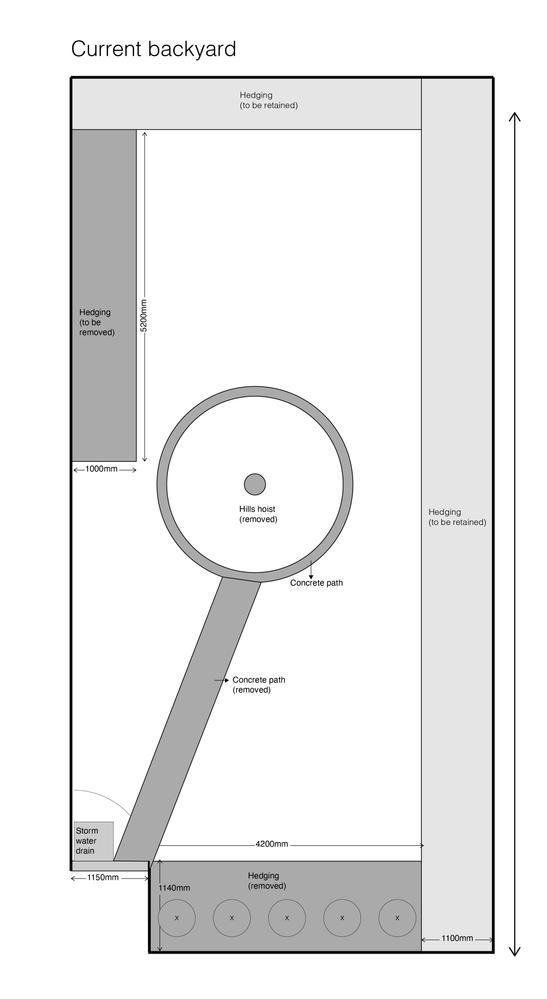

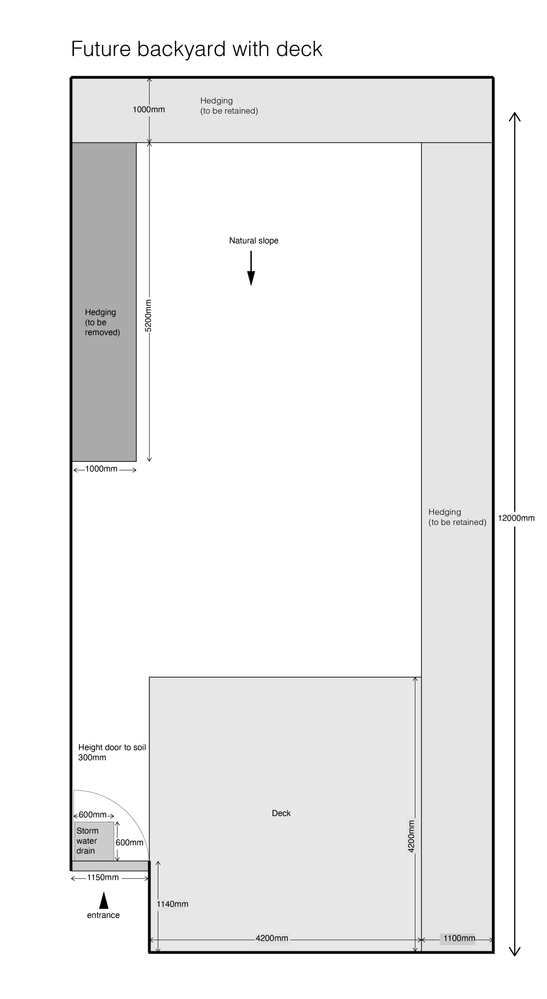

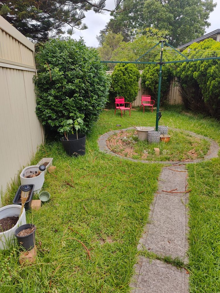

I am looking to build a deck with an open pergola in my backyard using timber, tuff blocks and concrete blocks. It will need to be a low lying deck due to natural slope of the backyard towards the house. Currently, the backyard has hedging on all the sides(we plan to remove them from 2 sides), hills hoist in the center (removed), and a concrete path that leads from the door to the hills hoist and goes around it- which has been taken out but we would like to reuse if possible. I've attached the current yard with the elements mentioned and the future yard with the the deck. Please advise what materials and tools are needed, spacing, and how to plan for the drainage.

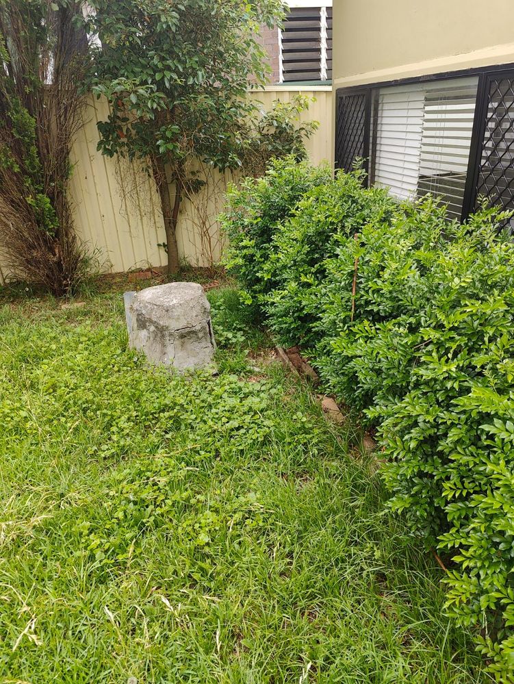

Firstly, is it possible to get some photos of the area you are planning to install the deck? Your plans are brilliant, but oftentimes, regardless of how good they are, they do not convey everything and seeing things can help us notice things that plans can not convey.
The next question I have is, how much height do you have to work with? Oftentimes, decks are constructed so that they sit flush with the bottom of a door sill, or under a windowsill. This height restriction will always have an effect on the design and materials chosen for the deck, so it is an important detail for us to look at.
Low-level decks are definitely possible, but the limited ground clearance that is inherent with them is not ideal, as it limits airflow beneath the deck. This can cause premature timber rot and associated issues with your deck. You'll want to look at ways to maximise the airflow below the deck, which ties in with how much height you have to work with. Ideally, the deck should have as much ground clearance as possible, so things like excavating the ground and using materials that maximise ground clearance are important.
Seeing that the ground naturally slopes towards the deck, we should also look at ways to add drainage around and beneath the deck. Seeing that there is a stormwater drain nearby is good, because it means you can install agi pipe beneath the deck and have a plumber connect it to your stormwater drain. Maximising the ability for water to drain beneath your deck, combined with maximising the clearance from the ground, will be the two most important things we need to look at before selecting materials.
There is no one single way to build a deck, so we need to look at the whole project before selecting materials. H3 Framing is commonly used, and in low-level decks, H4 Framing, which is treated for use in close proximity to the ground, is ideal. Once we have some details about the ground clearance and drainage in that area, we can look at more specific materials.

Regarding the height, the doorstep leading into the backyard is 300 mm high from the soil. Hence the deck will sit below it so that water doesn't go into the house.
Regarding the drainage, the aim is to put a french drain 1 metre from the house walls and a gutter that goes around the deck into the stormwater drainage.

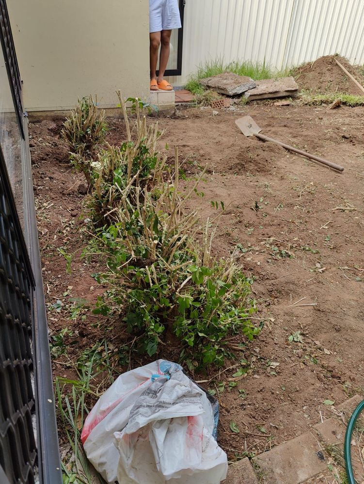

Current challenge is to cut the bushes that lie close to the house walls as it sits where the french drain should be. Hence the french drain will be placed after that. Furthermore, the stormwater drainage is a concrete column which means to connect the agi pipe, a hole has to be made at 1 feet depth. If not, the french drain/agi pipe will redirect the water away from the stormwater drainage to the other side and into the soil. Atleast the water is redirected away from the house walls.

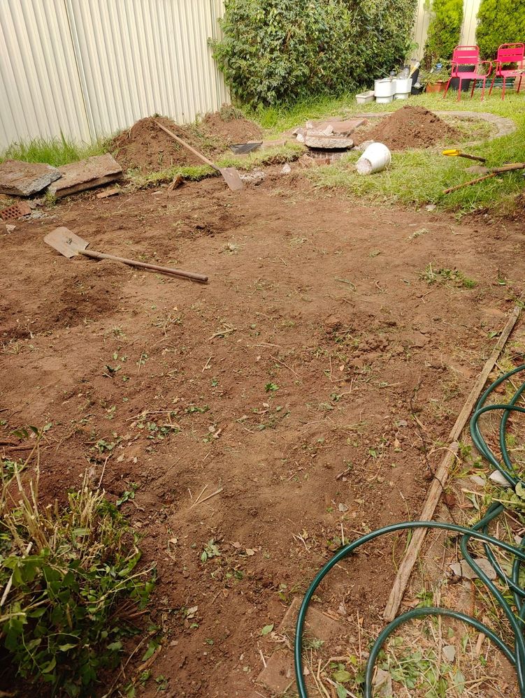

I have shared before and after pics. So far I have lifted the concrete path, removed the grassroots, and had an attempt at uprooting the bushes (reciprocating saw failed as it is a bit inaccessible and takes a long time if I do a horizontal cut. Any suggestions appreciated). Next task is levelling and drainage.
Should I maintain the natural slope, put gravel on top and level it? And then place the tuff blocks? Or should I make the top soil also flat and then put gravel followed by the tuff block?

The images of the yard before(with the concrete pathways and hills hoist) and the current image with the turf layer removed is attached.
