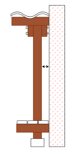

I'll start building the roof for the deck this weekend. Below is a side view, and the question is if I should be securing the post to the brick wall to make it more stable. If so, could you please let me know what screws and packing to use? Should I also use decking tape for flashing?
Also, what brackets should I use to secure the rafters to the bearers, given that they will be sitting on top? Thanks.!!!

Hi @evisbal,
Provided a suitable sized post has been used which is capable of holding up the deck and roof and securely fixed into the ground, then it shouldn't need additional fixings to make it more stable. Do you have any concerns about its stability?
If you do have concerns this would be a question best posed to an engineer.

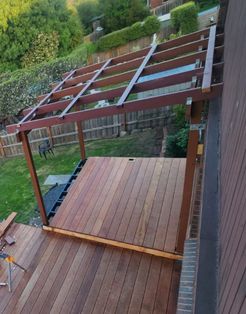

Hi @MitchellMc, thanks for the advise provided so far; project is going well, find below a photo.
Regarding the face board, I will be using the same merbau decking, should I just screw on the framing or should I leave a gap between them, just like the reference images below? Thanks.
Re: How to build a two-level deck?
That's looking great, @evisbal!
I think most would screw the fascia board directly on, but it would be best practice to leave a gap so moisture and debris don't get trapped and cause decay. These plastic shims can be used to establish the gap.
