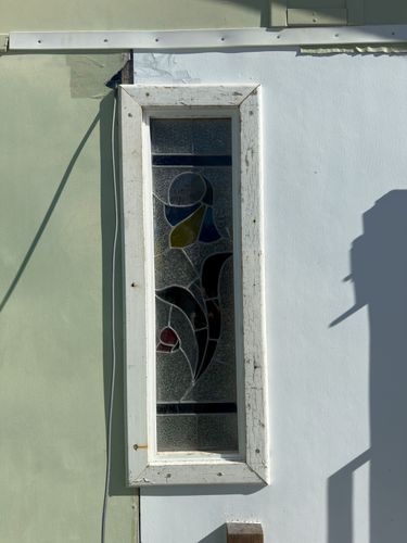

A while ago my builder and I halted our renovations due to a lack of funds. We fitted a tall narrow stained glass window, which my Mum made, in between the timber frame (studs). Until now, I've just filled in the gap around the window frame with paper towels and packing tape on the outside to block the weather and insects.
So, I'd like to install a simple hardwood frame; could you please help me understand what to do here? What wood can I buy from Bunnings? I would just like to get a hardwood plank cut up and have the two sides plus the top and bottom screwed into place, painted and caulked. Do I put screws in through the external window frame to the studs as well as into the stained glass window frame, just the stained glass frame, or just the studs? Do I remove the chock once I have other sides screwed into place?

Well, we are halfway done...
I had to remove a 4m downpipe, add some Brutus cover trim, clean down and paint the undercoat on the raw fibro, then I caulked all around the window before working on the external frame.
We had some old timber from a door frame that I did a test run on for the 45º cuts, and the other half decided it worked well enough to stick with. So now all the gaps are covered until we get time to unscrew it, sand and paint it, then reinstall and caulk it. Hopefully that will happen on Tuesday.

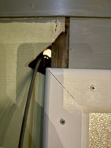

Next thing I need to learn is how to fix broken fibro such as the hole at the top left of the window shown here. Also, those Brutus trim's bring a question to mind, as someone who lives in a 'bushfire prone zone' (thanks Council and insurance companies), I think that these will just melt and provide no benefit at all, am I right? My house really is a dogs breakfast, but I'm learning bit by bit and making improvements as I can afford to.

Just as an option with that hole in the fibro, how about installing an extra piece of timber across teh top of the window, kind of like a header that overlaps the window both sides, covering the hole in the process? Silastic it as you install so the top and side is waterproof around the hole and you may get away not having to replace the fibro

You've piqued my interest with that line of thought. From the bottom of the grey horizontal brutus fibro trim, to the bottom of the top horizontal window frame piece, it is 180mm. At minimum, I'd need a 500mm piece of wood to make it cover the fibro gap and be balanced across the top of the window. The challenge is that the fibro gap drops down below the top edge of the external frame...
I could glue a piece of timber using the construction adhesive to cover the remaining gap, and balance it on the other side. Alternatively, I could get a deeper (top to bottom, ie over 180mm) single piece of timber and cut out where the window frame is on the bottom side, to create a one piece addition. Much like a [ that is rotated clockwise 90º. The only other option we've thought of is to cut out another piece of fibro to match the gap and glue and nail it into place, then do the final frame caulk to make it water tight. What do you think?

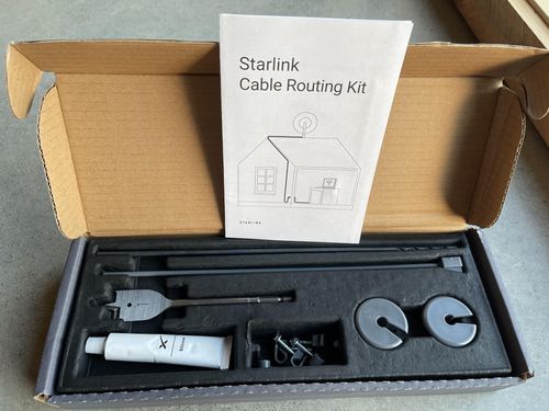

I ordered from Starlink their $19 cable routing kit to make a nice neat cable route through the wall as well, which I'll need once this fibro gap is filled.

That cable routing kit looks great. I'm putting my vote to the extended piece of timber at the top. I also propose moving your internet cable below the window (close to the floor if possible) so that it does not interfere with the overall look of your window.

I agree with @EricL on moving the starlink cable if possible. And here is what I was meaning with the thicker timber trim added to the top and bottom of the window (to make it match) I was thinking Merbau, which comes in 90mm and I think 180mm? or 190mm? Its just as a cover overt the hole so nothing gets in. The small bit thats left, you could do what you were suggesting with a piece of fibro or use the Sika Foam that @EricL suggested.
The purple is merbau, probarly the 180mm ish thickness.
