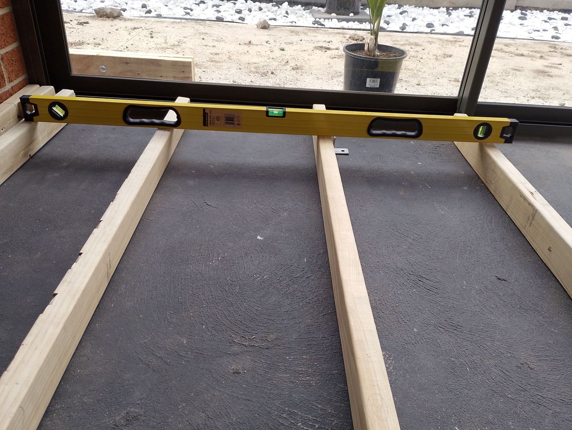

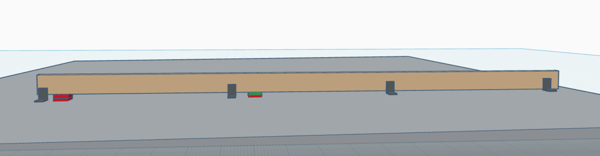

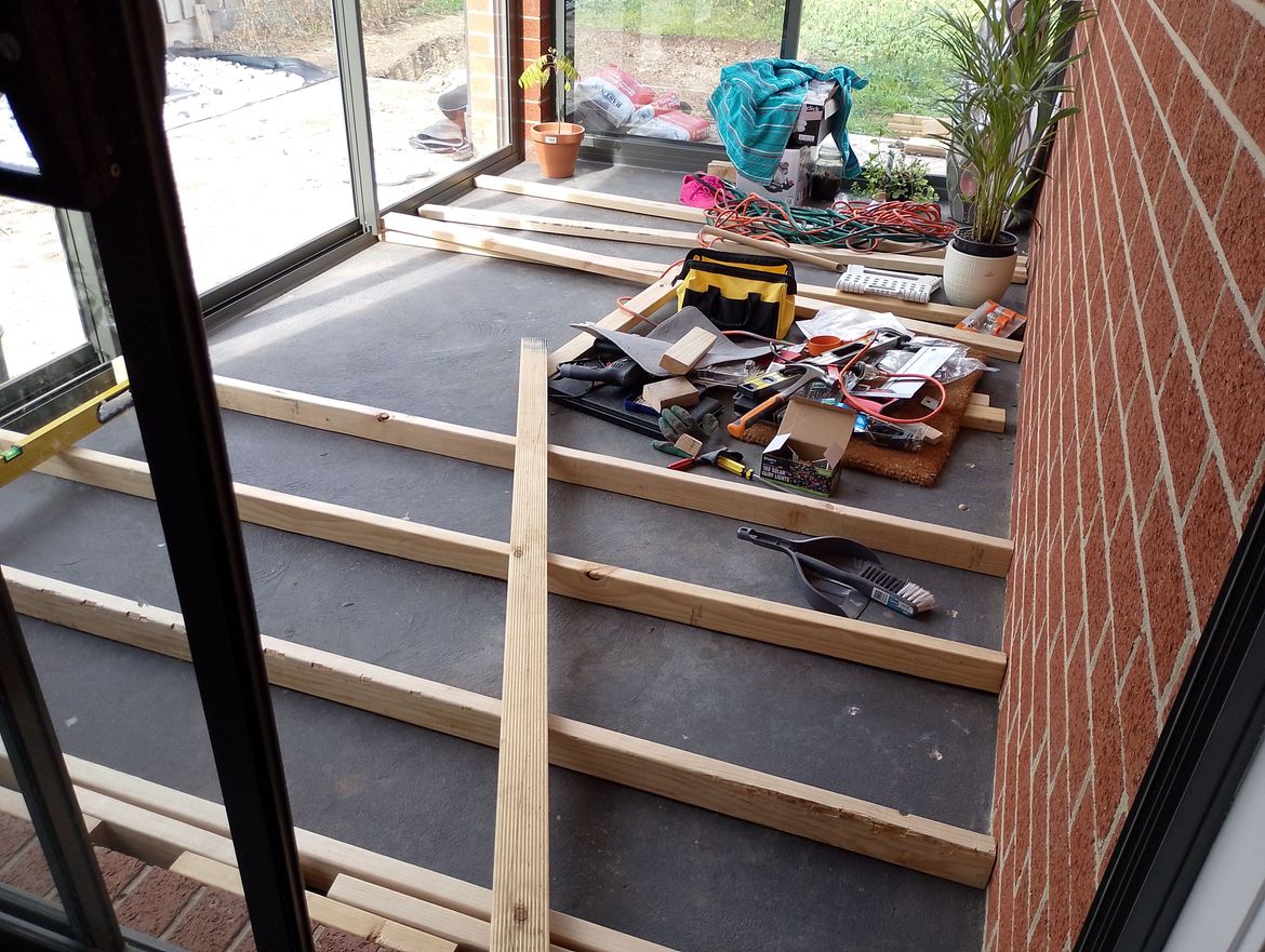

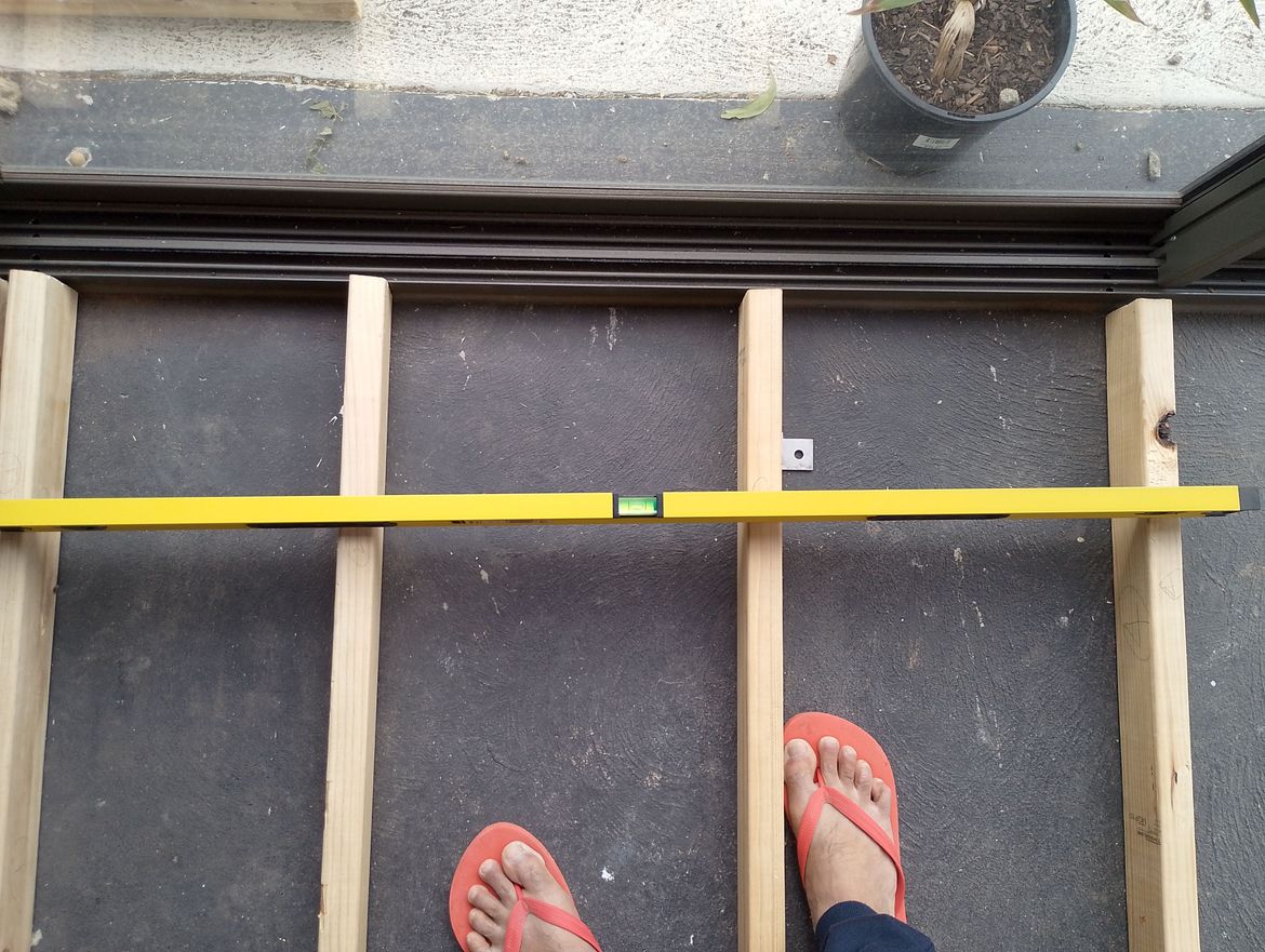

Just a quick question. How do I negotiate a slope when building a deck on a patio which has a slope, away from the building.

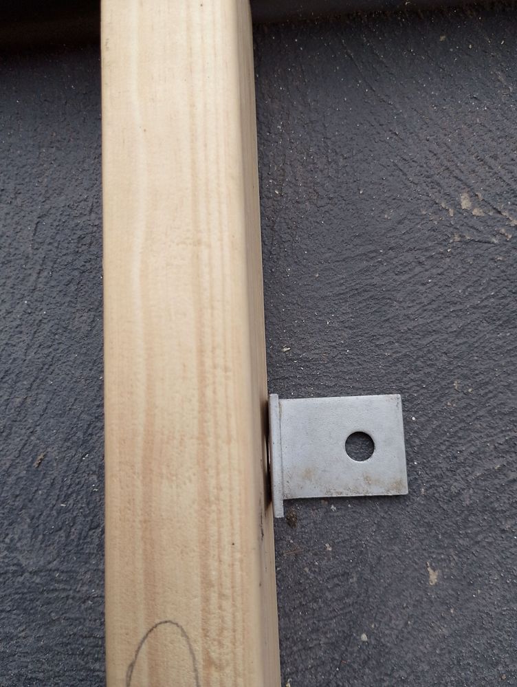

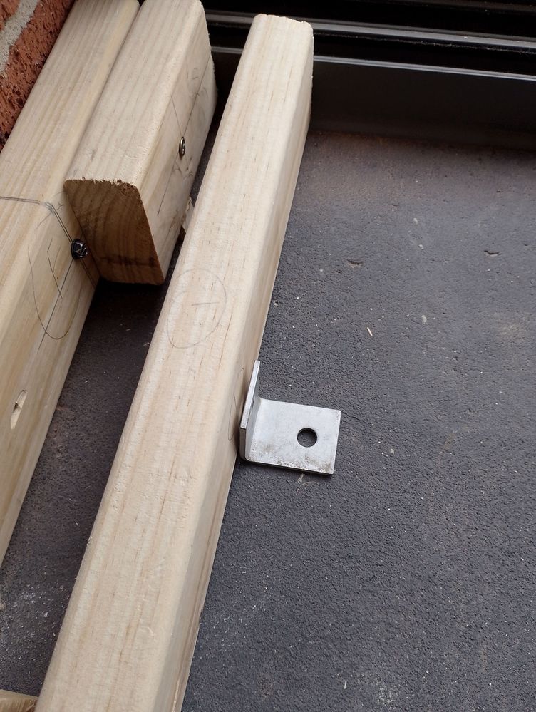

Pics enclosed. I intend to use dyna bolt the angle brackets.

You can deal with the slope by packing under the joists in the lower areas until the deck is level. Once you’ve packed it to the right height, drill through the timber at the correct position and secure it to the angle brackets with bolts. Essentially, you’re just lifting the timber where needed to create a flat, even surface for your decking.
