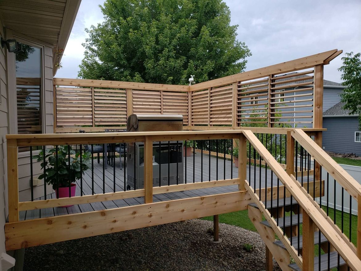

I'm looking to build a balustrade/handrail system similar to the below for a small outdoor balcony:
beautiful-privacy-wall-above-deck-railing-on-raised-deck-flexfence-img~1561ca390bcb90c3_14-9580-1-6d91af0
Just curious to see what peoples suggestions are on the best way to approach:
1) Getting the vertical aluminum bars (cant seem to find these pre-cut - is the only option to make my own out of a long piece?)
2) Best way to attach these to the wood (i.e. lots of pre-drilling vs some sort of attachment)
Thanks in advance
