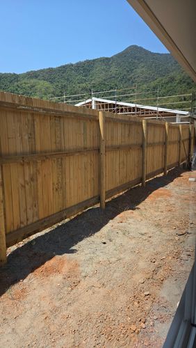

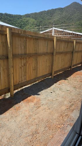

Hi there. I'm trying to figure out what to put as an edging for the right hand side of our fence. For starters our lot is about a meter high from them. When the contractor built the fence the neighbor didn't go for a retaining wall so the fence was just erected as per the natural contour of the land. We want to make a paver pathway so I need a way to support those pavers along thw fence.
My initial thought was to use 200x50 h4 sleepers against the pailings and just drill them to the posts and support it with like jack 450mm sleeper pegs. My worry with this is the whole fence might topple over either side because of the sleeper's weight. Another thought would be just to haunch it with cement. Another is tuscan path stone edging. Ideas would be amazing at this stage. Thank you.

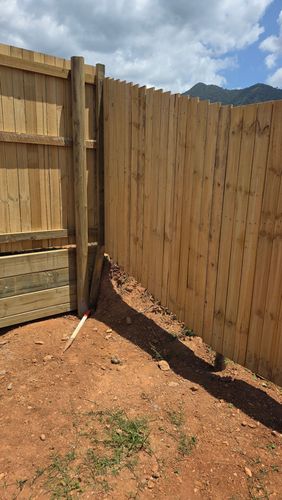

Thank you Eric that actually worked. I can show photos later.

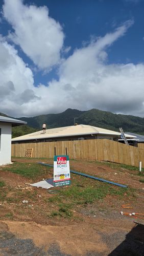

Down to the other side of the fence.
We want this to be a paver pathway only with about 20 pavers 600x300 or 400x400 and the rest will be just drainage rock.
This side is a bit of an angle towards the middle. We are still trying to figure out if we aregoing to put sleepers on this one Against the posts. My thoughts were to level it with road base so its not that of a concave. We wanted sleepers to prevent whatever is coming from the
neighbour's side. I thought of reinforcing them by digging a bit of a trench and fix the sleepers with sleepers pegs. My concern is that the sleepers may not support the weight of the fencing and will end up collapsing. I thought of edging but its not high enough to prevent whatever is gonna come from the other side. Apologies my thoughts are all over the place.
