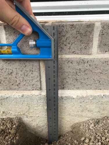

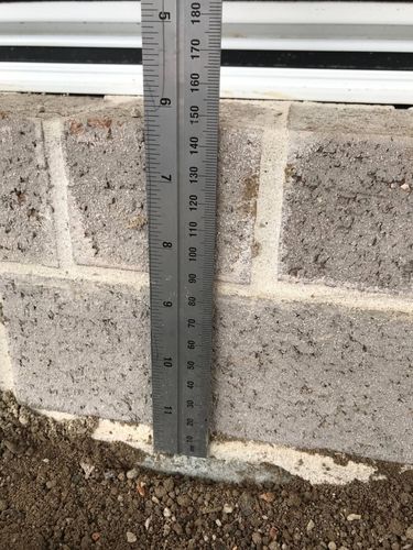

For context this is where I am up to at the moment:
The plan is to fill the back yard 50mm below the slab height and then lay turf on top taking the lawn to slab height (about 50 cubic meters in total).
Under where the decking is going I have needed to fill this so that any water will not sit under the decking and become a pool. To do this I have put in Crusher Dust with the plan to compact it sloping away from the house.
Have a put in about 150mm deep of crusher dust currently:
Leaving me about 150mm to work out the decking (height of bricks).
Dimensions for the decking is about 8000x3000mm.
So as to not void the warranty of the house I don't want to connect the decking to the brickwork and will leave 10-20mm gap for termite inspections etc.
Close to the house I'm not sure how to go about setting up the posts / bearer supports.
At the end & on the sides I can do Posts at 400mm deep x 300mm wide (I think thats right?)
