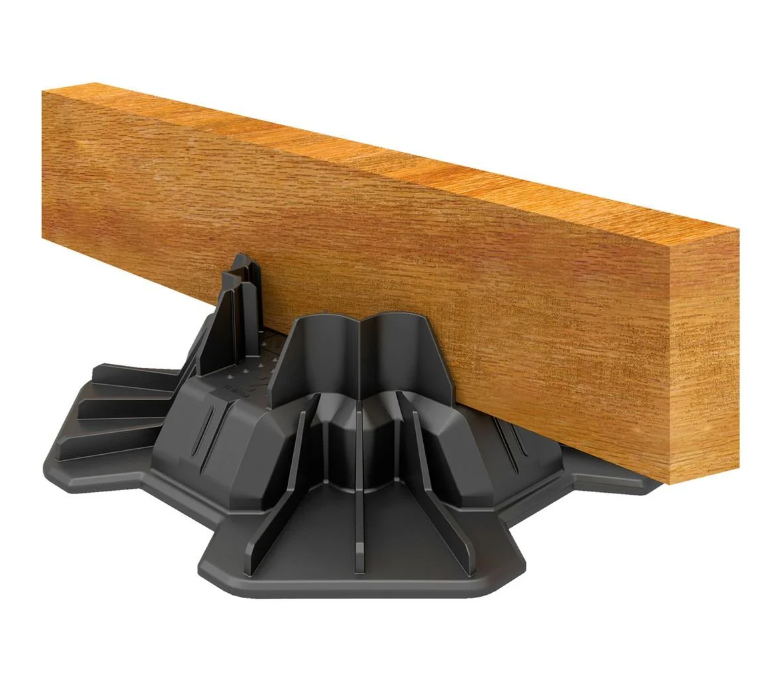

If using the tuffblock does it mean i have to use packers 45mm the slot is 90mm?
Re: ground level deck.
The vertical slot is 90mm for posts @biggysi. The horizontal slot is 45mm for joists, as per the image below.
