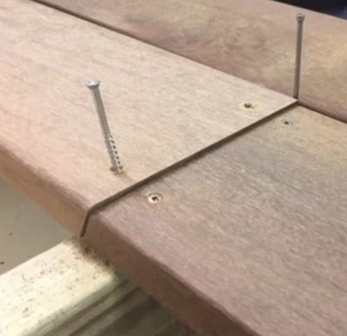

When joining the boards to the joist, I am concerned that, when there is a join, the screws of both boards have very little timber to screw into and in addition, are quite close to the end of the decking board (about 10-12mm). Is it better, when there is a join in the decking boards, to add an additional block to the joist so that each board has more to fix into (obviously the block must be well secured to the joist (or be a complete additional joist).
If you can assist with some options that would be appreciated.

It's normal practice to drive the nails into the joists slightly skewed so, essentially option 1.
Assuming you're using a standard gauge decking screw, ensure the pilot hole is between 10mm-15mm back from the edge and driven in on a slight angle to get the bite you need into the 45mm joist. To be safe you could use the next 1/2mm up so there is no stress on the board. Depending on the screwed type of the screws your using will determine if you need to also countersink. I use a seperate countersink bit for ends over combo ones for end boards, but I drive that straight. And lastly avoid over-driving the screws here.
I would experiment with a few offcuts to work out best distance from the end, angle and countersink method.

As @Nailbag has already mentioned, it is normal for your screws to be driven in on a slight angle. With a 45mm wide joist, as long as the join is centred over the joist, you can set them back from the join by 15-20mm and drive them in at a slight angle, which will give them plenty of purchase in the joist.

I did my screws around 10mm -12mm ish from the ends of teh boards and I went straight, not at an angle (had never done a deck before) It does make sense what @Nailbag and @JacobZ have said about screwing at an angle but straight still works :smile:

thanks for the help and the photo. It is really good advice. on your photo, it looks like the ends of the boards have been cut with a slight angle also; is that correct? if so, what angle are you running?
