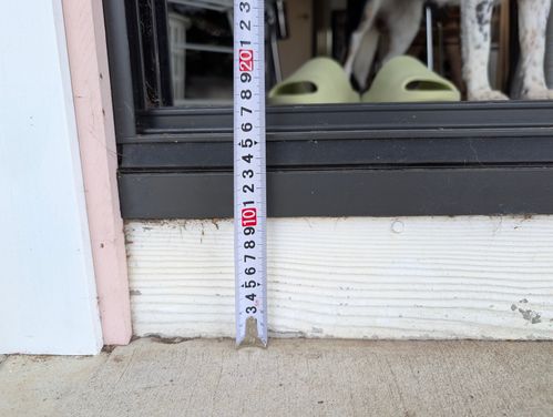

Hi Bunnings community,
Amateur DIY-er here, I'm currently planning out the build of a deck over a concrete landing at the rear entrance of my house. First off, a few photos to show the current setup, as well as some of the dimensions. The main slab is 2.4m by 1.2m, with a thickness of approx 10cm. The top of the slab is 83cm from the (stamped) concrete patio below. For the house side, the slab to the bottom of the sliding door is 13cm, and the slab to the metal trim angle is 10cm.I also want to deck the stairs in the same format, but planning around the main landing area first.

Your deck should go no higher than the finished floor level inside your home; otherwise, you may have issues with water getting inside. Based on what I can see, I would say this is at 130mm above the concrete landing.
With this limited space, none of our pedestal options would work, so you would have to use packers with angle brackets to attach them to the landing, or another solution that is capable of supporting your joists that low to the concrete.

1. I would go bottom of the sliding door to reduce the height difference too. Being able to then use a standard 90mm x 45mm joist will make life much easier and conventional.

1. I've added a clearer picture with the door open. To match the inside flooring, it's probably more at the 15-16cm mark. Would it make much difference to go either to the 13 or 15cm (besides the additional clearance between the joists and concrete)?

For the deck height, going from 13cm to 15–16cm isn’t a huge difference @shrewdly4957. The main consideration is the clearance between the joists and the concrete. At 15–16cm you’ll have slightly more room underneath for airflow, drainage, and any minor leveling adjustments, which is generally a good thing. The height difference inside versus the deck will only increase slightly, but it will still look neat and be easier to work with structurally.
