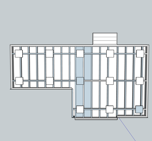

I’ve created a SketchUp model where the squares represent the Tuff Blocks (attached for reference).

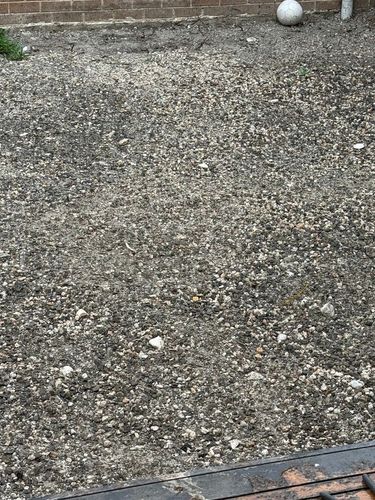

In the attached photo, you’ll see the existing crushed rock base.
  • If I compact this thoroughly using a hand tamper, is that sufficient for laying the Tuff Blocks?
  • Would you recommend adding more crushed rock or using a plate compactor instead?

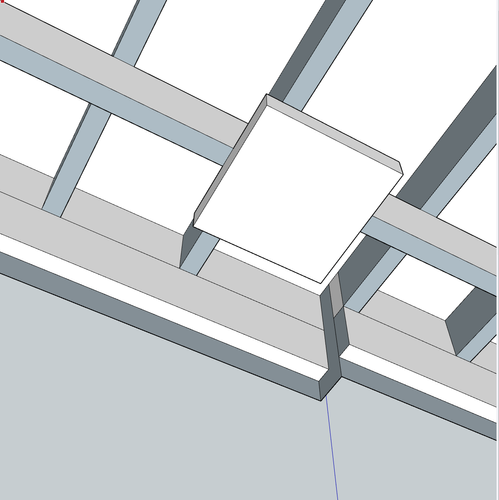

I’m planning to use two ledgers on the house:
  • One ledger for the beams
  • One ledger above it for the joists
My thinking is that this will:
  • Help everything line up cleanly
  • Make levelling easier
  • Allow joists to be hung directly from the top ledger
I’ve attached a photo showing how I’m imagining the ledgers stacked.
  • Is this approach sound?
  • What’s the correct way to waterproof and flash the ledgers against a brick veneer wall?
  • Should there be a gap, membrane, or flashing detail I need to include?
  • What screws or anchors should I use to fix the ledger to a brick veneer house?
  • Given that the deck is still supported by Tuff Blocks on that side, what fixings are appropriate?

In regards to your foundation, I suggest adding more crushed rock and using a plate compactor to level the area. Please double check with your engineer regarding your wish to use TuffBlocks. I don't think it's necessary to have two ledgers as there won't be a lot of connections added to the bottom ledger.
