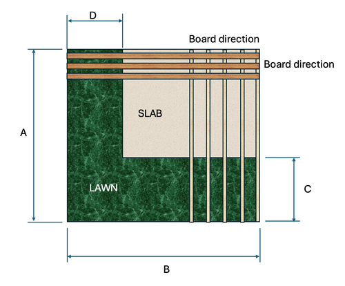

I have attached on the plans the area that will be concrete under and dirt. For the dirt section, where and how many holes do I need to pour the concrete into?
Sorry if this is a stupid question
Thanks heaps

Afternoon @rwa1994
25 holes and concrete needed acording to thoswe plans. Note that the holes near the slab you may run into concrete foundation material so adjustments may need to be done. You wont know until you dig your holes next to the slab. I ran into the same issue when I was working next to my brick wall.

I have to say I am unclear on the design plan @rwa1994. Ultimately what @Dave-1 has suggested being concrete/stump hole. However on my first impression of the layout there appears to be over-engineering here with 25 stumps for a total deck size of roughly 4.6m x 5.6m given 50% is over a concrete slab. Thats of course if my layout below is correct?
Joist should be at 450mm centres to the boards, but depending on the joist dimensions, your span between stumps once over the lawn can be far greater. Basically the same as the concrete anchor points in @JacobZ 3D render.
What are your dimensions for A, B, C & D?

My dimensions are:
A - 4667
B - 5580
C - 1547
D - 1860
I am clear from Jacob’s 3D render where the anchors need to go on the concrete slab but I am just confused about the grass portion. How does it connect into the ground and then onto the subframe of the deck?
Again, I’m sorry for the annoying questions. I am just trying to learn and give it a go
