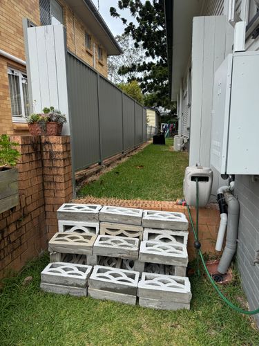

I did a partial prototype/option for her at the weekend based on some surplus blocks we had which was rejected as an aesthetic approach but was very handy to give her a sense of scale/volume:
Re: How to build outdoor steps?
Hi @kitfriendesq,
Unfortunately, the Peak stair stringers have only been manufactured for use with timber treads and are not compliant with concrete treads. I'd recommend you either go with the treated Pine or Merbau option.

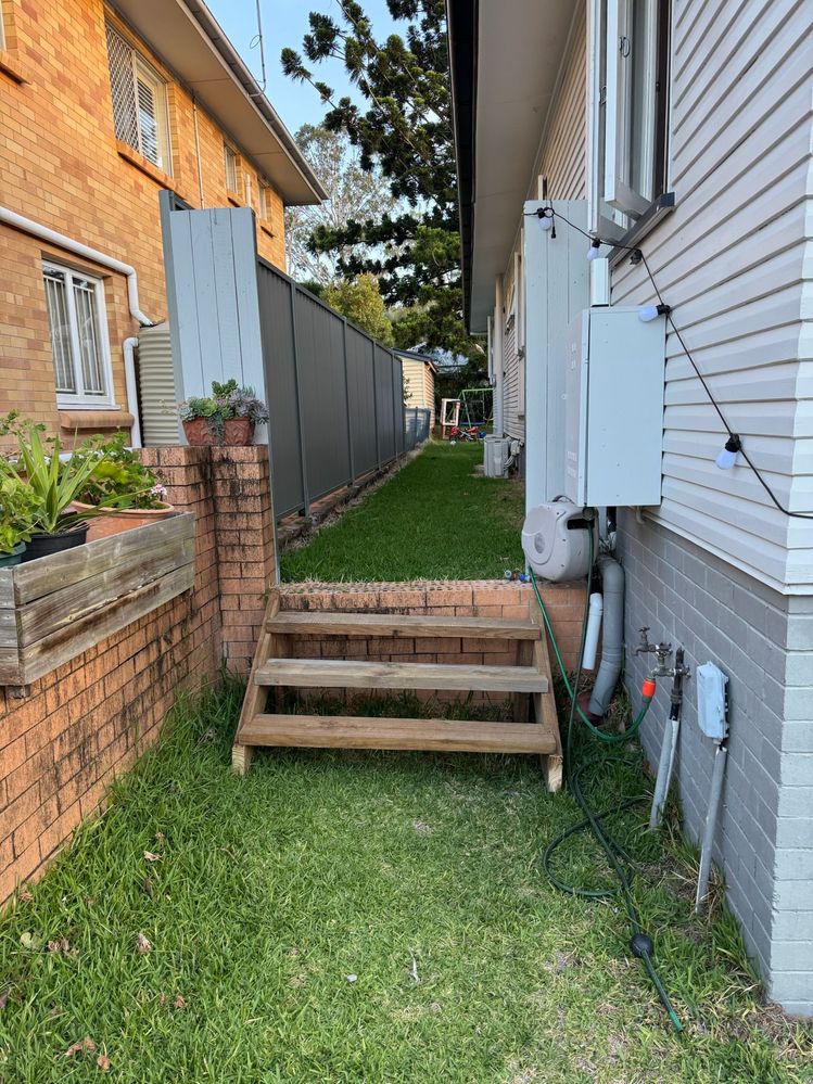

Hi all - I know everyone likes a project update here 😁
I ended up with enough spare chunky wood from a neighbour clearing out I figured I could knock something out for free here - so here's my new steps! Just got to sort some footings and bracket to the wall (I'll level it properly as part of that also).
Hi @kitfriendesq,
I love it when repurposed materials can save the day.
The stairs you've created look sturdy, functional and well-made.
Thank you for sharing the update.
