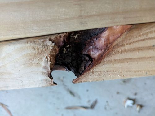

I have just been delivered of 190 x 45mm for beams from bunnings.
Noticed that one of them has knothole (like dia 20mm), do you think i can still use this for a beam?
Re: Pergola footings
The timber has been structurally graded, and knots are taken into account when the timber is assessed and stamped @dogbural, so from a structural point of view, a single knothole around 20 mm in diameter isn’t going to compromise the beam’s load-carrying capacity for a pergola. In other words, it will still perform to the rating it was sold under.
Where it can be an issue is visually. A noticeable knothole in a beam that’s on show isn’t always what people expect when they’re purchasing larger structural members. If it’s going to be visible and you’re not happy with the look, I’d suggest contacting the store you purchased it from and asking if you can swap that length over. That’s a pretty reasonable expectation, especially if the timber is otherwise unused.
So structurally you’re fine to use it, but aesthetically it comes down to whether you’re happy with how it’ll look once installed.

Thanks @MitchellMc - I have ended up having it replaced.
