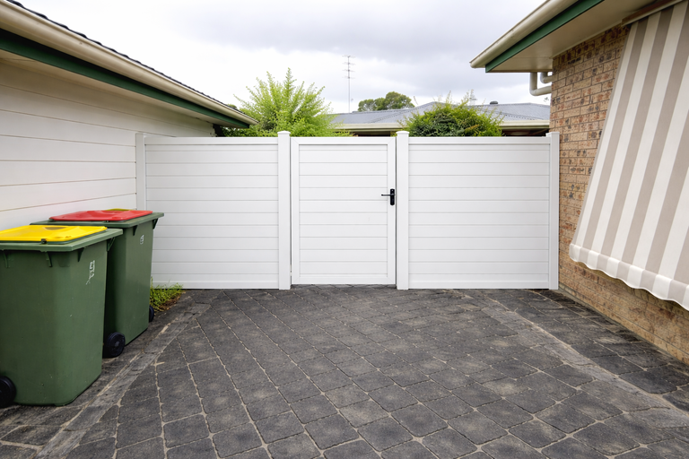

I am building a fence (with a gate) at my property going from my garage (left) to the house (right). I threw my dimensions and ideas into AI and it spat me out with this image (below). I have a good understanding of how to build the frame of the fence, but unsure what my best option is for the paneling in the middle. This fence is a short term solution before we renovate and build in this area, so we are more so looking for an affordable option that keeps our children and dogs secure in our back yard (with no ability to see through the fence).
Thanks so much!

Good job with the visualisation - that will help other members to understand your goal.

Good Afternoon @haveacrack92
hahahah and here I am disliking AI and it does such a nice job of rendering a photo :smile: That really looks good.
As a temporary/permanent solution (all my temporary ones tend to be forever ones) ive always thought this would look ok.
James Hardie 4200 x 180 x 16mm Linea Weatherboard
If you frame up rectangles to fit between the gate posts and walls and add in a midd horizontal it would be solid enough.
For the gate I have been looking at these for ages
gate frame shows a whole range of them. You could mount the same hardie board on the frame I would think. You may need a couple of horizontals to space it out so its level tho.
Oh, post holes... Nothing less then 600mm deep fi not 800mm deep. You dont want them wobbling :smile:

Hi @haveacrack92,
G'day Mate, just work up from arvo nap and wondering why you asking about building something when it's already there!
I won't add anything because I agree with @Dave-1's suggestions.

Re: How to build this fence panel?
It's an Ai generated photo @AlanM52 😁

Hi @haveacrack92
You're not going to be able to build anything even temporary thats strong enough unless you're prepared to make a couple of decent holes in your driveway to support dug-in posts or more simply use stirrups anchored to the concrete. The later would be my recommendation as would be to search on marketplace for 2nd hand pool fencing and gates. They are a dime a dozen, easy to install and super cheap. This would be an ideal secure solution for a temporary fence with gate to keep the kids and muttlies in.
