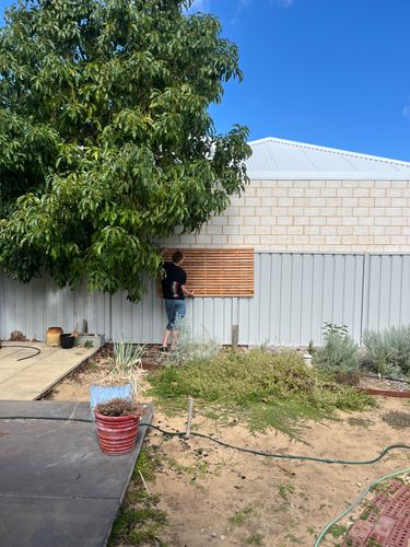

I want to cover my colour bond fence with a horizontal wood slated fence/lattice fence.

- I’d like to have wood/lattice fence panels starting from half way up the colour bond fence ending slightly higher than the colour bond fence. Does this complicate things in regards to support and the horizontal timber method?
I’ve attached a photo of the colour bond fence and how I’d like the panels to sit. As in one panel above and one panel below.

While your Colorbond fence is in good condition, it’s important to note that it isn’t designed to support additional weight like merbau panels. The posts and footings are specifically engineered for the weight of the Colorbond sheeting itself. Hanging additional panels from the Colorbond fence, while possible, could place stress on the structure and potentially compromise its integrity over time.
The safest option would be to install timber posts in front of the Colorbond fence to properly support the lattice or merbau panels. This would give the weight-bearing responsibility to the timber posts, rather than relying on the Colorbond fence to carry the load. The timber posts can be spaced appropriately and fixed into the ground, either using concrete or post anchors, to provide the necessary support for the panels.
As for the design, having the panels start halfway up the Colorbond fence and extend slightly higher than it shouldn’t complicate things too much, but it may impact the horizontal timber method. You would likely need to install additional timber framing behind the panels to support the weight at the top and bottom. This will help distribute the load and provide more stability.
If you prefer not to install posts in the ground, you could try using brackets or heavy-duty mounting systems to fix the panels directly to the existing fence, but again, this would still place weight on the Colorbond posts. So, to avoid any long-term issues, it’s best to install separate timber posts for adequate support.
Ultimately, while the merbau panels are a great choice for aesthetics and durability, ensuring proper support for them is key to maintaining the integrity of both your new fence and the existing Colorbond structure.

Could you talk me through the process of installing additional timber framing? Do you mean similar to the framing in @ProjectPete ’s pool fence? https://www.workshop.bunnings.com.au/t5/Outdoor/Fence-makeover-for-the-pool-area/td-p/9732/page/4
I noticed he says his frame is just supported by the fence in this instance!
if I were to anchor the frame against the colour bond fence by the horizontal timber bits and have the anchor posts underneath would this provide necessary extra support but still use the colour bond fence as extra security?

The post anchors would be for independent posts, not the Colorbond fence posts. They would need to be concreted in.
Additional horizontal framing that lines up with the edges of your panels. "I’d like to have wood/lattice fence panels starting from half way up the colour bond fence ending slightly higher than the colour bond fence. Does this complicate things in regards to support and the horizontal timber method?" I was inferring that if you want to start panels halfway up the fence, you'll need a horizontal framing piece at that location, instead of the bottom of the fence as mentioned earlier.
Pete's fence would be an example of an extreme amount of weight hung off it, and in most situations, panelling will be fine. However, we can always tell whether your fence has been installed with adequately sized footers and whether it will react the same.
