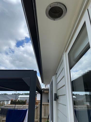

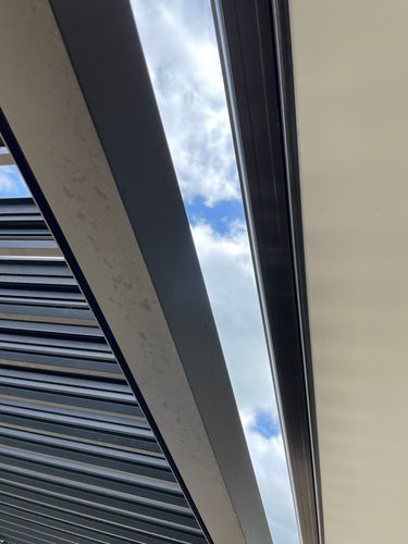

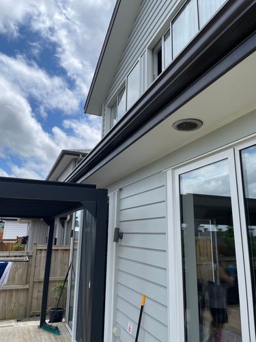

Just working on our outdoor area. We got a 6x4 louvre installed however when the deck was built it wasn’t measured properly so now we have a bit of a gap between the house and the louvre where water comes through. Any ideas on how I can close this gap?
Gap is about 56cm out. So need something to cover 4m x 56cm?? Thanks

Thanks everyone for your suggestions. I think my photos don’t show just how big the space is. Maybe calling it a gap wasn’t the right word… Our ceilings in the house are 2.7m and the gazebo is only 2.4m so the space between the house and the gazebo is about 50cm+. The sliding door frame
sits higher than the gazebo. I have attached another photo from inside to show this space. I am trying to ensure that no water at all gets through. Could I possibly use flashings? Maybe I will need to get a custom flashing? Or maybe corrugated roofing somehow? Thanks again for all the suggestions so far!
