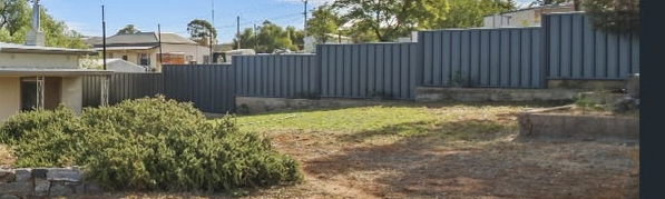

Hi All,
i have a colourbond fence that i want to attached a cat run too.
Unsure what the best way to go about it would be.
I want something that will last.
Cat is 8kg and distance between posts is 2.4m.
Re: How to connect a cat run to Colorbond fence?
Welcome to the Bunnings Workshop community @5uperman. It's terrific to have you join us, and many thanks for your question about attaching objects to a Colorbond fence.
The best way to connect a cat run to a Colorbond fence will largely depend on the size of the cat run and the forces that will act on the fence. Colorbond fences are not designed for load-bearing purposes. The posts and footings are only intended to support the weight of the fence itself. This means you shouldn’t rely on the fence to carry the weight of a cat run. You could use timber or similar supports pinned to the fence to help hold parts of the cat run in position, but the fence itself shouldn’t be expected to bear a significant load. It would help to know more about your cat run: is it a prefabricated unit, or are you planning to build it yourself? Understanding how you intend to attach it and why it needs to connect to the fence will allow for more specific advice and safer solutions for both your fence and your cat.
Perhaps if you can draw us a sketch, that would help convey the project.
