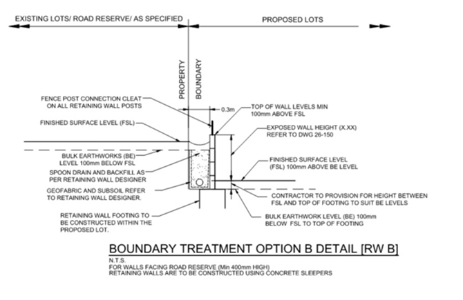

I have a similar retaining wall and Colorbond fencing situation as the photo in the original question above (similar retaining wall height, mostly 700 m high with smaller portion of it going up to 1 m high). My rear boundary is about 300 mm from the back of the retaining wall, and I would like to put a Colorbond fence with a sleeper underneath at the boundary. But all the Colorbond fence contractors that have come out to quote just want to install the fence on top of the retaining wall (developer left fence brackets on top). They are saying the retaining wall is too close to the boundary to dig posts, but we've seen it done all the time around the area and other estates. Is there a way to use the existing fence brackets to reinforce posts at the boundary? Should I be approaching retaining wall companies? I've got a fencing company coming to quote that also does retaining walls, and I'll be very surprised if they also say they won't dig posts.
I don't know where the gravel above the retaining wall drain would usually start, and the developer won't give me the retaining wall design or company details of who installed it. Their response was I should just be using the fence brackets on top. Attached was the approved retaining wall design I pulled up from developer's application from the Moreton Bay council site. I am on the proposed lot side (the lower land).

Unfortunately, you couldn't safely install fence posts along the actual property boundary without damaging or in some way affecting the drainage, which is an essential component of any retaining wall.
Generally, fence posts will have concrete foundations that are 300mm in diameter and, depending on the height of the fence, anywhere from 600-1200mm deep. If the posts were to be installed directly along the fence line, then half of this concrete foundation would protrude into this 300mm section of drainage gravel and would likely hit the agi pipe at the base of the trench.
The issue you'll find is that installing these concrete posts would considerably alter the drainage characteristics of the retaining wall, and anyone installing that fence would assume legal liability if the retaining wall were to fail because of this alteration. This is likely the main reason you are having contractors refuse to build the fence in that way. Unfortunately, unless you were able to find a contractor who is willing to accept that liability, then I doubt you'll have much luck getting someone to build your fence along the surveyed property line.
Unfortunately, I am unaware of a way that you could safely use the fence post connection cleats on top of the retaining wall to build a fence along the property line.
It may be a pain, but I can't really see a way that you could avoid having the fence run on top of the retaining wall.

The retaining wall system that was installed on the blocks look like it has been built purposfully to carry a fence plus allow drainage of the same walls. It does make sense that installers wouldnt want to change that as it complicates who is responsible for failures down the track.
If we had a photo of the retaining wall and it showing your boundary line we maybe be able to come up with other ideas. The problemis my imagination keeps bumping up against the boundary line itself. The retaining wall sounds liek it is the boundary line even if the drawings ssuggest its a little further away. You will gain back the slice on the other side if it has the same style retaining wall maybe? A photo would help us out picturing it for sure.

Thanks for the reply. Our boundary is definitely behind the retaining wall and looks exactly like the photo originally posted above. The registered survey plan confirms this and surveyors pegs are behind the retaining wall. Wouldn't a recommendation to the original poster to dig a channel or drive pegs in behind the retaining wall also affect the retaining wall drainage?
Some of the fence contractors also told us we can't put a 1.8 m high fence panel on top of the retaining wall due to increased height from natural ground. We would need to apply to council for approval and because the retaining wall isn't on the boundary, we would solely own and be responsible for the fence and the backfill/drainage we wouldn't have access to.
Council originally approved to have the retaining wall on the boundary, but the developer moved the retaining wall and drainage onto our side so that the retaining wall and backfill/drainage would not affect the neighbouring high side from their use of their land (i.e. the retaining wall only benefits our side), but then the developer also stated in the land contract the fence doesn't have to be on the retaining wall.
