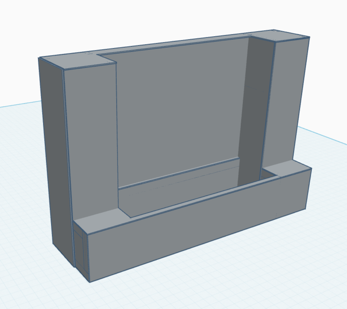

Creating a water feature wall like the one you’ve shared involves a fair bit of construction work, but with the right approach, it can become a stunning focal point in your garden or outdoor area. Depending on your preference, the main structure would typically be built from either timber framing or masonry blocks. Timber is a bit more DIY-friendly and easier to work with if you're building it yourself, while block construction offers a more permanent, solid option.
Once the framework is in place, it would be clad with fibre cement sheeting to provide a stable, smooth surface ready for tiling. The recessed channel where the water flows down needs particular attention—this part of the structure will act like a mini pond or trough, so it must be fully waterproofed. You can achieve this using a pond liner or a waterproofing membrane like Crommelin Pond Sealer. Ensuring it’s completely sealed will prevent water damage to the framework underneath and help the system run efficiently.
To create the waterfall effect, you’ll need a water pump installed at the base of the feature wall. This pump will recirculate the water up to the top of the wall, where it can be distributed evenly via a sprinkler bar or spillway. This bar needs to sit flush along the top edge of the tiled recess to allow the water to cascade smoothly across the face. You’ll want to make sure the flow rate is balanced to give you that nice sheet of water without overshooting or splashing unpredictably.

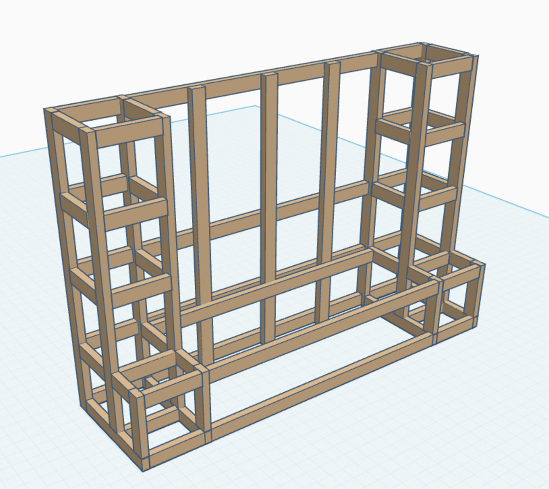

To help visualise the setup, I’ve included a rendering that shows how the internal timber framework might look before and after cladding. It gives you an idea of how the wall can be built out, with support battens and cavity space to run plumbing and secure the water reservoir. The pump, plumbing, and any lighting features should all be installed before you complete the final cladding and tiling stages. Remember to enlist the services of an electrician if running with 240V lights.
If you're after a simpler build or a plug-and-play alternative, Bunnings also stocks freestanding water features that might deliver a similar look on a smaller scale. But if you're set on a custom feature wall, taking the time to plan out the framework and waterproofing will go a long way to ensuring it's a success.
