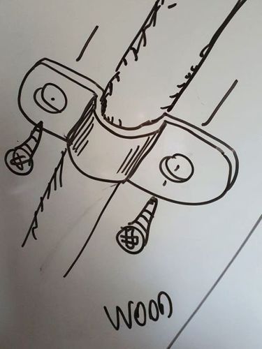

Would you happen to have a picture of the webbing strips you'll be using? I'm just curious to know what kind of material it is. Is it weatherproof or is it just ordinary thick fabric? Using a timber panel is definitely an option as you can attach it to the steel frame with steel saddles. This will save you from having to drill into the steel frame. You'll also have the option of either leaving the timber as is and just painting it with polyurethane or upholstering it.

What are 'steel saddles', please?

"What are 'steel saddles', please?"
I think this is the hardware @EricL is referring to.

You're on the money, as usual, @Noyade. The product that @EricL was referring to for @nonsibicunctis's project are steel pipe saddles.
