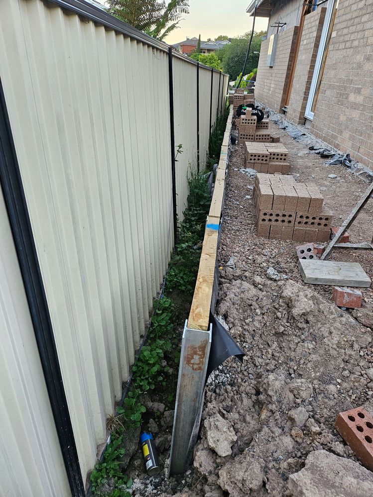

Hi, we are building and the way they have cut/filled the block has left us considerably higher than our neighbour and a concrete retaining wall has been erected 400mm away from the existing colorbond fence. the depth is between 1000mm and 1500mm for most of the length of the block. I have seen other similar situations rectified by putted decking across however that was being supported by a timber fence. We can't back fill as that will eventually pop out the colorbond fence on our neighbours side. Any suggestions would be welcomed. Thank-you

In order to give our members a better idea of the configuration of the fence and retaining wall, would it be possible for you to post a few photos of the layout? Once our members see what it looks like, we'll be able to offer recommendations on how to move forward.

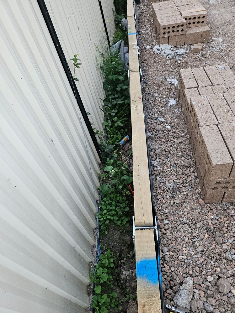

I hope these images help.
Thanks for your reply.
Also, sorry I thought this retaining wall was concrete - it's timber sleepers. (we have a concrete retaining wall on the other side of the property)

Thank you very much for sharing those pictures. Now we've got a better idea of what's going on, I propose going with your proposed solution in your post. The "decking cover" can be supported by building a timber angle bracket anchored to the face of the retaining wall. The decking cover will not be that heavy and can be used as seating. However, I would not load it with anything too heavy as it might affect the retaining walls position. Its main purpose is to cover the gap and prevent anything and anyone from accidentally falling into the gap.
If you have the same situation on the other side of your property, the same solution can be applied, and the timber bracket can be drilled into the concrete face of the retaining wall.
Let me call on our experienced members @Dave-1, @AlanM52 and @Nailbag for their recommendations.

Hi @Maj,
I propose alternating sections of pot plants and seating.
Seating section - timber supports in shallow holes filled with ready mix concrete.
Pot plant section - Planter box with pot plants and topping of your choice, pebbles or mulch etc. supported with brackets.

Thank-you for your suggestions too - they're great. We may indeed break up the decking with pot plants. We'd need a post hole digger to put in timber supports, but it is certainly doable if we decide we need more support.

You have a nice solid retaining wall there :smile: and yeah the gap is always a problem.
I am thinking of a two fold idea, along the lines of @EricL and @AlanM52  but a little different and hopefully cheaper.
Using 140 x 19mm Merbau SpecRite Pre-Oiled Decking - Random Lengths
You firstly install some vertical posts screwed to the timber sleepers themselves. If you do the math you sleeper is 50mm wide I think, then if you screw a post sized timber to it you could get another 70mm to it. The timber dosnt have to be nice as you wont see it but has to be able to survive being outside. It wont touch the ground as its only screwed to the top and second sleeper maybe.
So you have 50mm sleeper, 70mm post (or larger)
You could run a narrower board on the sleerper side and then the 140mm can be run with it overhanging teh "post" by a third if needed, I wouldnt go further than that without support.
If you want let me know and I will see if I can sketch it up.
