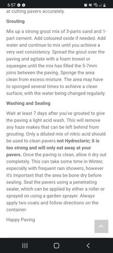

Hi @AnnaSophia,
I have always used a sand cement mix to grout in the gaps of the pavers, some sites recommend sand only others recommend the sand cement method. See below for sand cement grouting method.
 Carl

It should do fine as the cement will set, you can always grab a small bag of paver sand and cement first and test it out on the larger gaps before committing to the whole area.

It's great that you've received excellent advice from @CSParnell. My best advice for your project is to mix the sand and cement really well before you push the mix into the gaps.
