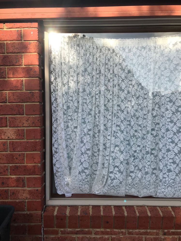

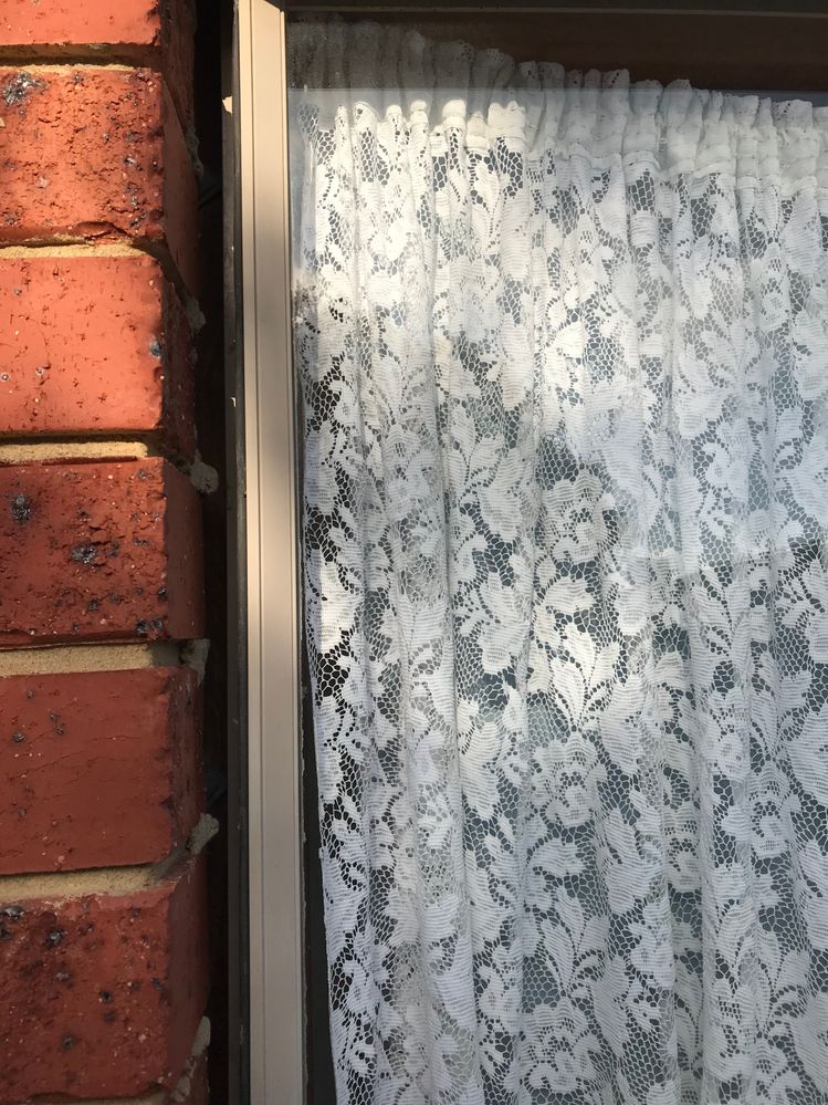

I have just noticed a large gap between my bedroom window and the brickwork. The gap starts at 1.5cm at the bottom and increases to about 2:5cm at the top. Any ideas on how to fill the gap would be appreciated.

We need to keep an eye on this gap. As the wall looks like a start point for a house extention as the brick work under the side of the window isnt overlapping more of a butted up join. And that section of house seams to have dropped down 1:10 given the gap measurments you gave.
And further concern is the brick mortar between the walls is cracked too suggests movement as described.
Is there crack on the other side wall or inside plaster. ?
All is good if that movement is now stopped. Just be a aware of this possibility and try and see why this is happening,
You may need to use an expanding waterproof Foam filler between the wall and frame not too much as to be over flowing.

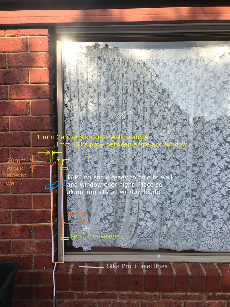

The Fix one option is to use an aluminium angle to glue( with sika Pro +) the flat bit too the wall with the edge pointing in, So you just seeing a flat metal face. As the wall goes up the metal edge will span across the gap to the top I would have the 20mm edge on the wall using the 32mm edge to hide the gap. Drawing may help here as a cut away. the aluminum goes all the way up to top.
Aluminum angle
1/ Cut the aluminium to size from the bottom of the window ledge to the top of the window.
2 /Mask the wall with any tape to try avoid messes. use aluminum as a guide pre positioned if you wish for tape masking position you will need a bead of Sika pro+ to seal aluminum to the wall the tape helps keep that neat.
3/ Put some tape on the 32mm side of the aluminum angle ready to hold it in place when glued to the wall
4/ Apply a 10mm bead Sila Pro+ on masked wall where the aluminium will fit, Slide the aluminium 20mm side to the wall the sika will squish and seal over the 20mm aluminum and wall leaving approx 1 mm space for the sika to fill now use the pre applied tape to stick it in place to the window., Pull up wall masking tape. Clean any excess Pro+ or add more as a external bead angle to the wall.
5/Let this cure over night to be safe.
6 Remove holding tape to window
7/ gently open a gap between window and aluminium angle 1mm min and wegde it open and caulk in sika pro+ to the open 1mm gap leave wedges (eg a pulled apart peg is wedge shape)
8/ let it set 24 hours. pull out pegs caulk peg holes.
After the aluminium angle is in place look to cauking up the cracks on the mortar underneath the window.
