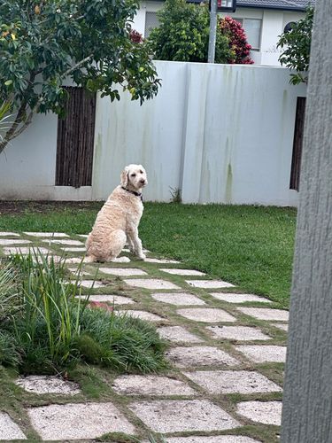

We have a perimeter wall with large gaps that have metal bars as a feature. Our dog wants to bark at everyone passing by so we are going to
fill the gaps. We have used bark fencing and cut it to fit the holes which worked until he worked out he could push his nose through and now the covers are falling off.
we could replace it and cover with a Perspex sheet but I wanted to aske on here for any easy and aesthetically pleasing ideas before we start again. We have 12 panels to fill so not a quick job unfortunately.
thank you

Good Afternoon @NikkiS
I am thinking (without seeing the internal holes
) that maybe install a rectangular timber frame (frame it out) on the inside with a horizontal batten if possible. Then attach hardiboard to both sides to make it secure and will stop rain falling onto the back of the villaboard directly. This you could paint to match yoru fence, even going as far as installing a picture frame look around the edge to enhance the look compared to leaving it flat.
Not doggo nose being able to push through that ![]()

this was the idea my husband has tried today. It seems to be going well.
i really appreciate your time!!
