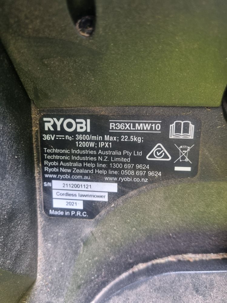

To start with, could you please let us know the specific model of lawn mower that you have? There will be a sticker or plate somewhere on it that will tell you the model number.

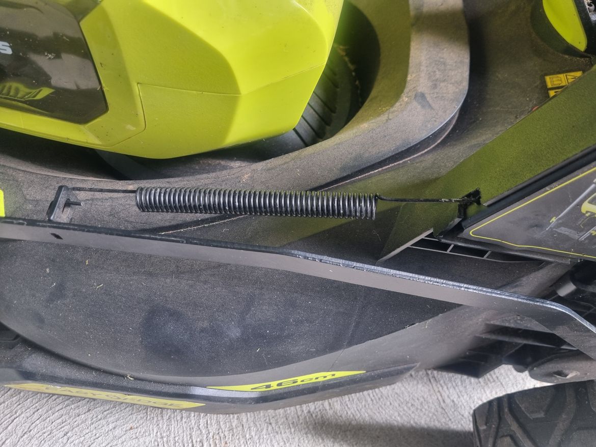

Additionally, a couple of photos of the height adjuster could help us work out what is going wrong. If you need a hand uploading photos, please let me know so I can assist.
It sounds like the height adjuster mechanism on your Ryobi mower has lost some tension or grip over time. This can happen as the spring or locking parts wear, allowing the lever to slip down during use.
Try cleaning the area around the lever and wheels to remove grass or debris. Avoid using oil-based lubricants, as they can make it slide more easily. If it keeps slipping, the internal spring or locking parts may be worn and need replacement.

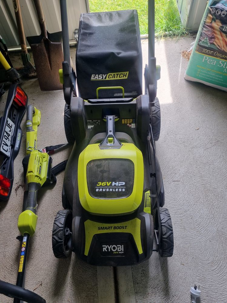

Hi JacobZ,
Images attached of the model number and spring. I went into my local Dural Bunnings and they said they don't have any stock, then I called Ryobi support and they said they do not carry any stock for the height adjuster spring, very disappointing given this model is still sold at Bunnings. I would expect them to carry spare parts for a spring, which is obviously going to lose tension over time.
