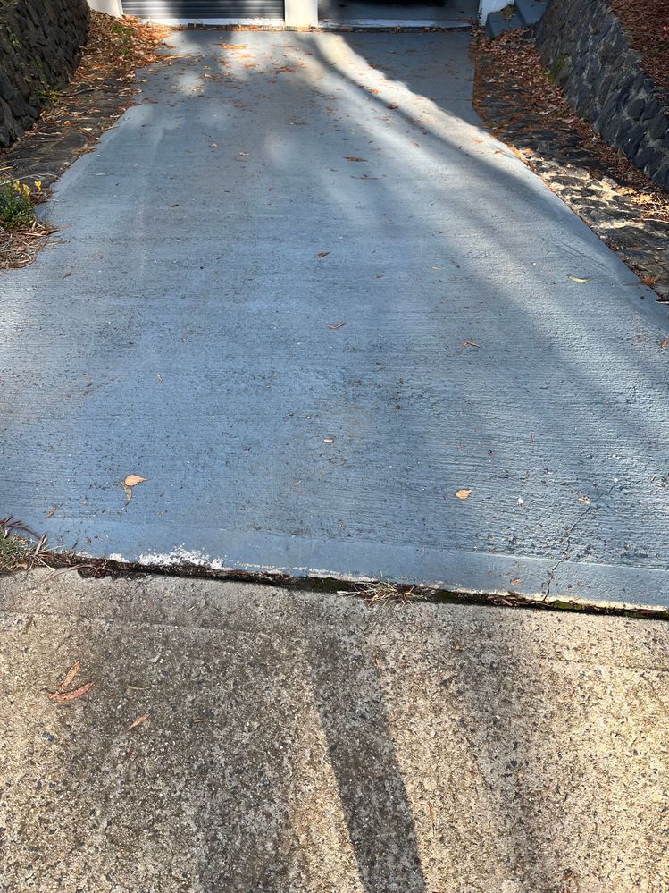

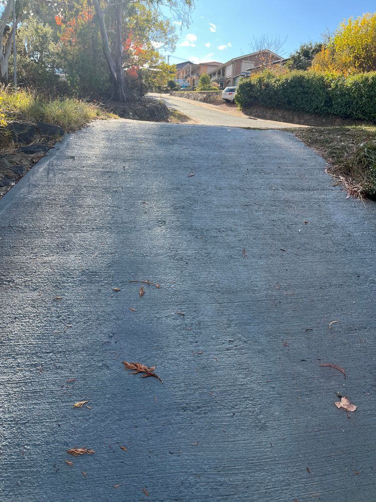

Hi everyone,
I’m looking for some advice or creative solutions from the community. I have a steep driveway, and my Tesla Model 3 (low ground clearance) keeps scraping the bottom when I try to park—especially if someone is sitting in the car.
It’s getting a bit frustrating, and I want to find a fix that doesn’t involve cutting and redoing the entire driveway if possible.
  • I tried Driving in/out at an angle (helps a bit, but not a complete fix)
  • Should i Install rubber or plastic ramps (any recommendations?)
  • Is it worth adding a small concrete/asphalt wedge at the transition point?
Before I go down the path of getting contractors involved, I’d love to hear:
  • Has anyone used driveway ramps from Bunnings or elsewhere that worked?
  • Any success with DIY fixes for steep driveway transitions?
  • Any cost-effective options that helped reduce scraping for low cars?
Would really appreciate any photos, product links, or your own experiences.
Thanks in advance!
—Dan

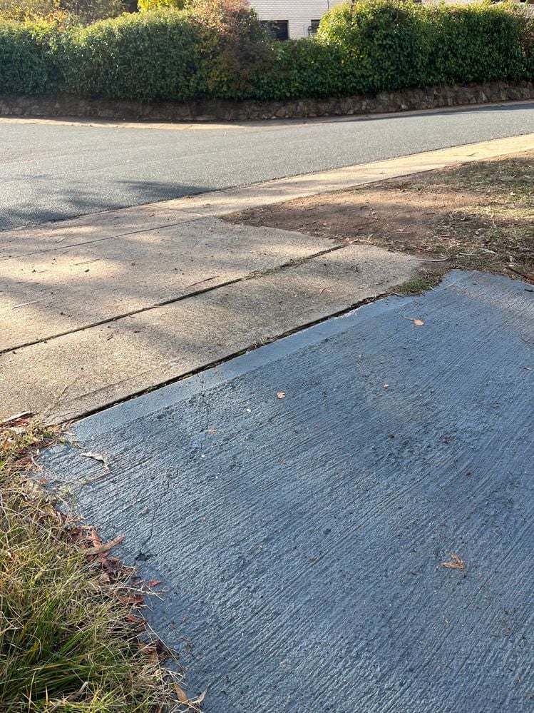

I don't believe anything you can easily install is going to help you with that dramatic transition angle combined with a low-profile car. Installing any form of rubber bumper is only going to leave marks on your car and potentially increase the issue.
For the sake of roughly around $2500 I think your best long term solution is to bite the bullet and remove the two concrete crossover sections and a couple of metres down the driveway and have it regraded and concreted. Any decent concreter will be able to assist in working this out as you won't be the first person with this issue.

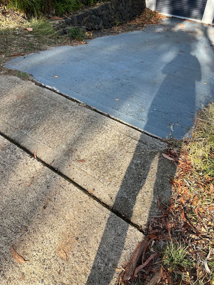

I also am thinking along the lines of ripping up that high point and smoothing it, I would be getting a decent concreter and someone who understands the issue to do the job. My only concern is removing too much of the rise and then having water come down the road and using your lowered driveway as a runoff point. The concreter should know how to manage that.
A note of caution as those two straight cuts across the driveway at the top look like some sort of service has been run down the footpath and the driveway was cut and restored to allow that to happen, a dial before you dig would be an idea as it should be deep enough but as you are lowering the rise then other factors need to come into play (mechanical protection of the services underneath the concrete is what I am refering to)

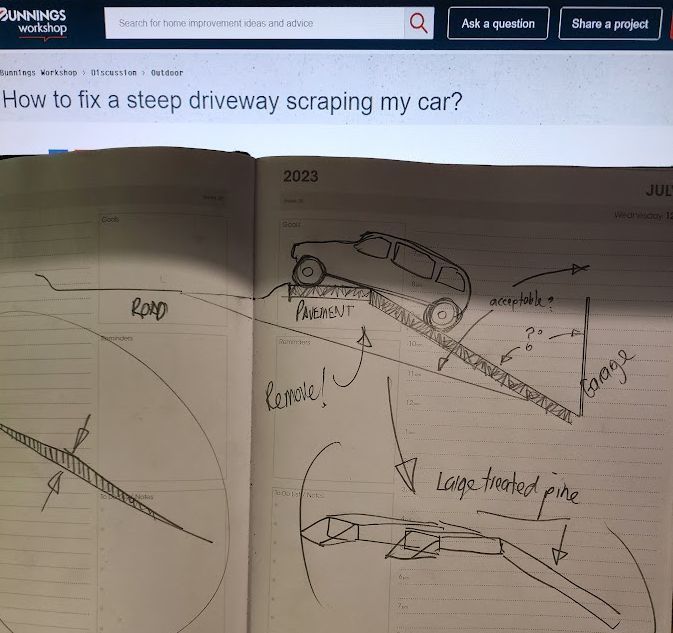

Do you know exactly where on your car the concrete is striking?
Is it a plastic protuberance, or is it metal?
Drinking and doodling last night - I was thinking or two speed bumps, strategically placed (a lot trial and error I suspect) running parallel down the ramp with the tapered end close to the horizontal sidewalk.
Of course you would need to drive up and down carefully with all the tyres on the ramps.
Possibly this will raise your car a few centimetres.
Just a crazy thought.
Cheers.
https://www.bronsonsafety.com.au/premium-large-modular-speed-humps
Forgive my drawing. Your Tesla looks rather antiquated.
