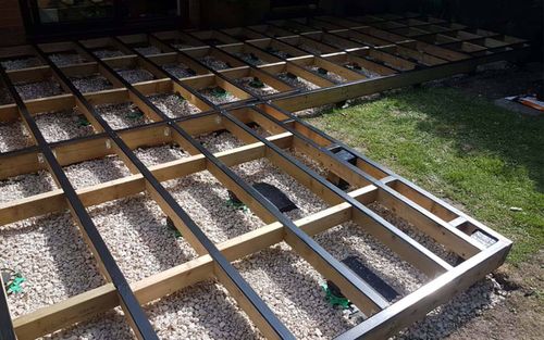

I think the suggestions from both @EricL and @Dave-1 provide an ideal solution to covering the retaining edge. I am more concerned about the stumps/supports I have highlighted with red circles. I was wondering if these are just temporary supports with concreted in stumps yet to be installed?
Without knowing actual span lengths you will need at least 2 stumps per joist and noggins with a single level sub-floor to prevent twisting of the joists. The photo below shows the type of plan I am referring to.
