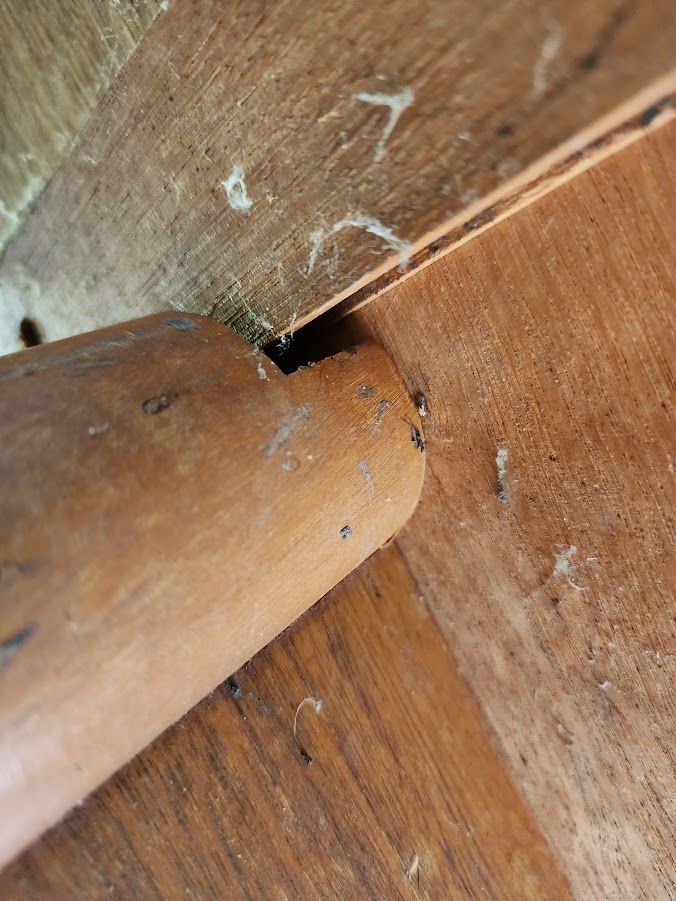

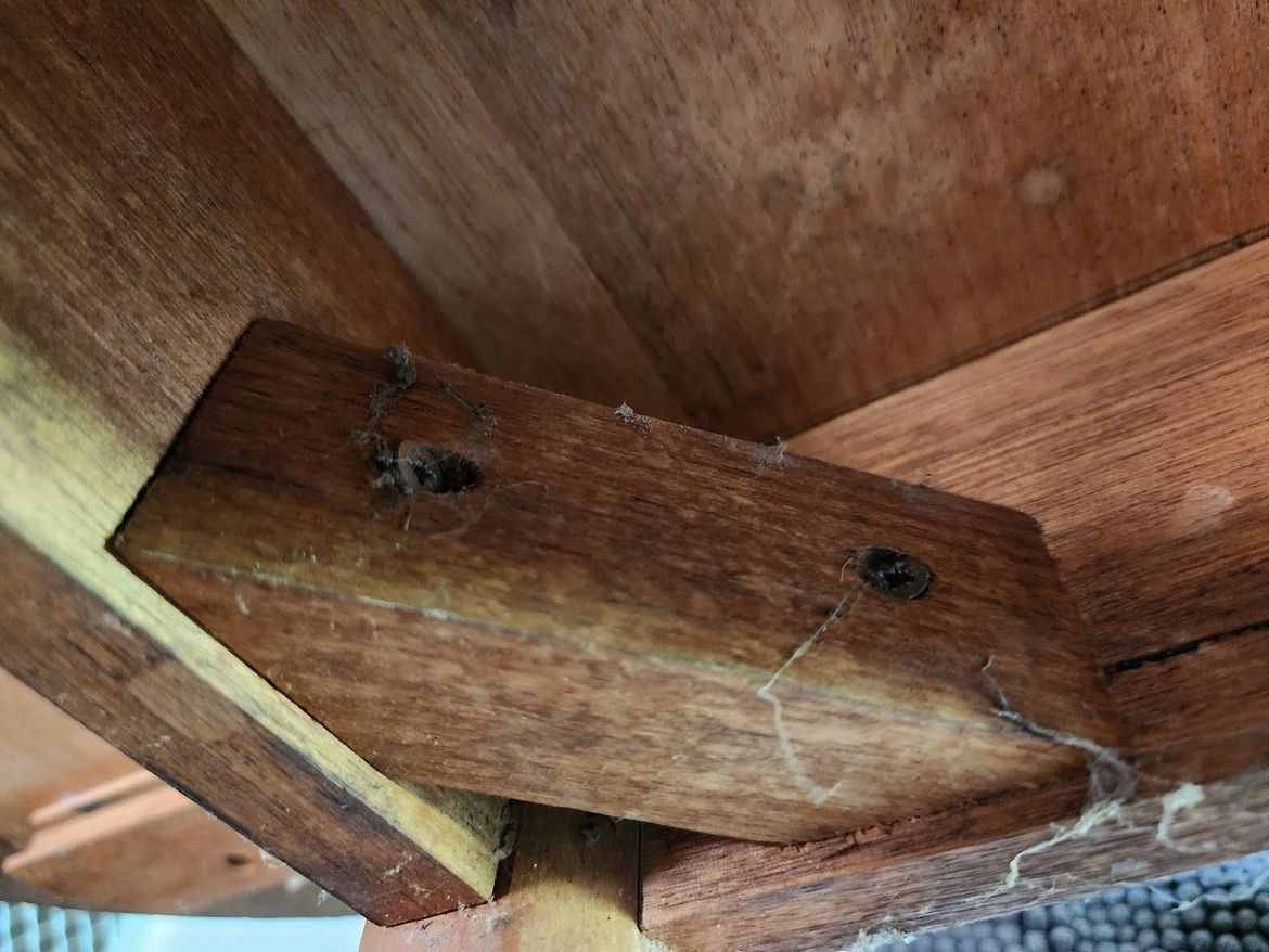

Old table I have outside.
Probably from the early 1970's.
Extendable ends.
There appears to be mortise and tenon joints involved?
Thoughts on how to strengthen them?
Cheers!

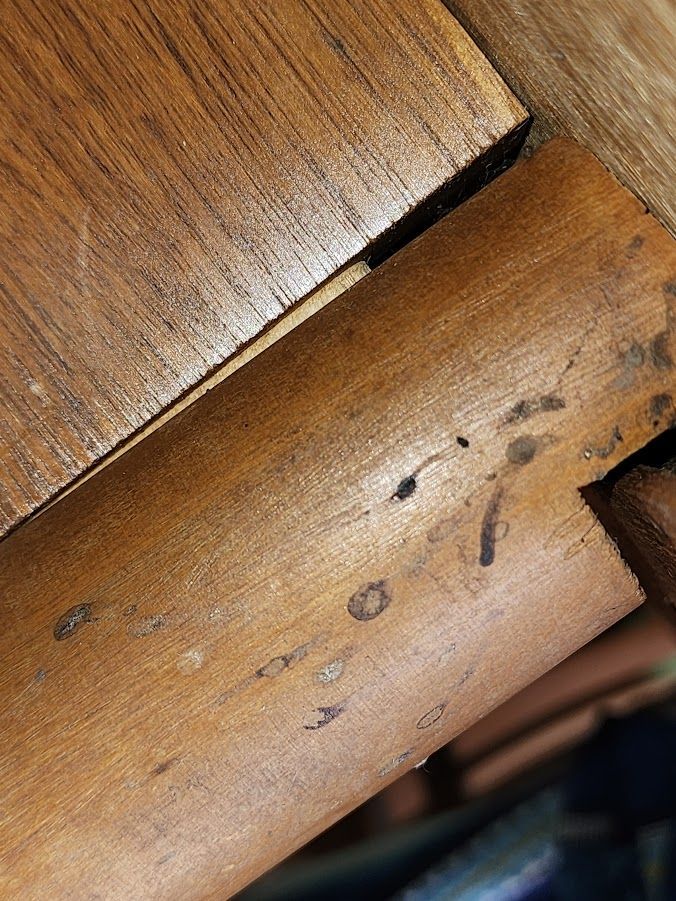

This shows the tenon spreading...

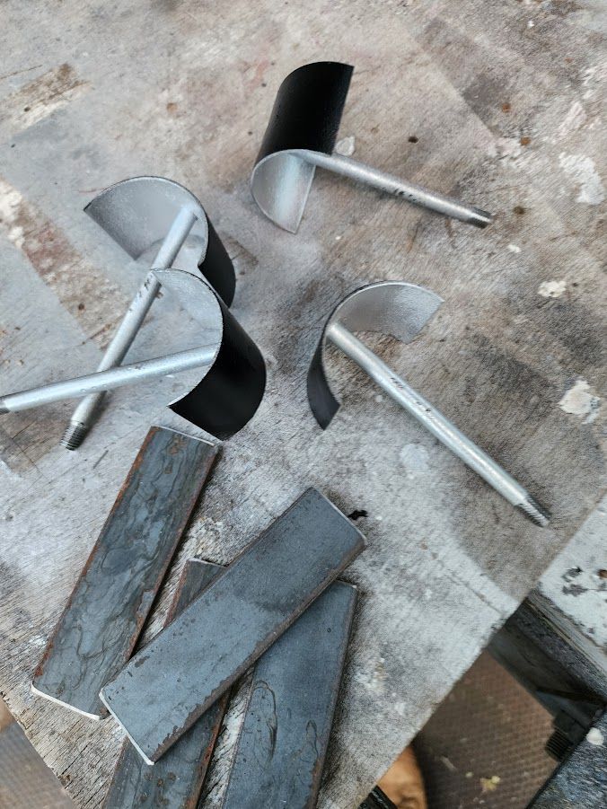

Re: Loose Table Legs.
Cut them in half.
Drill 8mm holes in the middle.
Insert/weld 8mm rod. Cut threads at the ends.

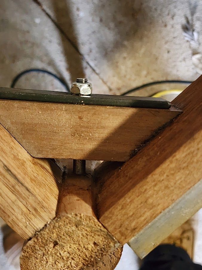

A work in progress - but you get the idea...
Hello @Noyade
That looks very creative, and that rounded piece will provide an excellent hold.

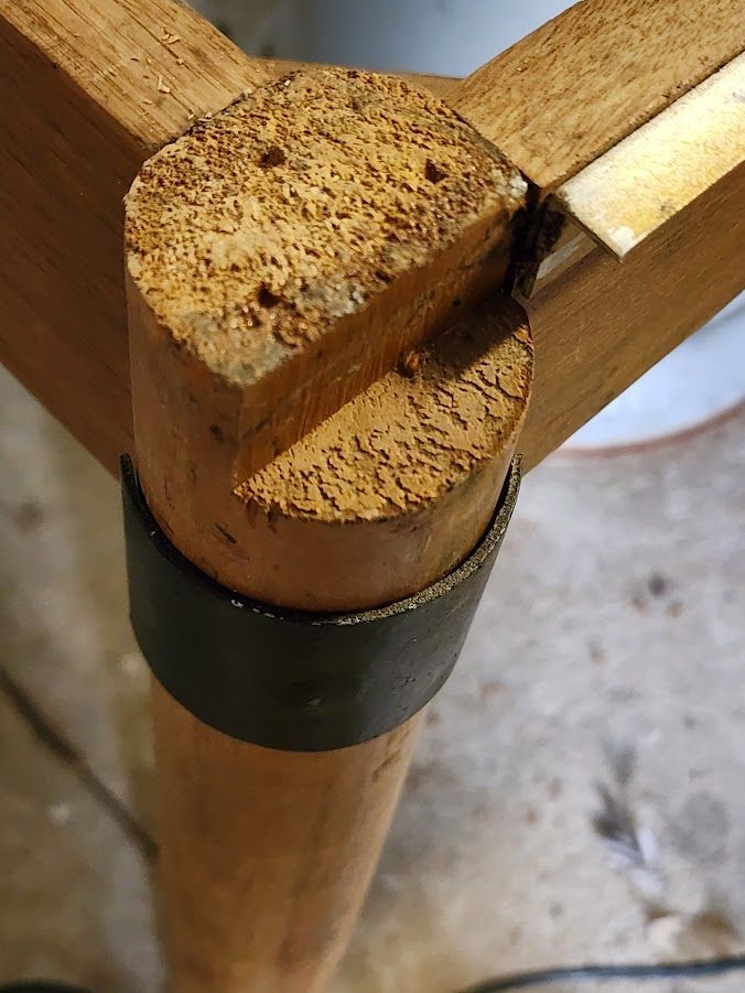

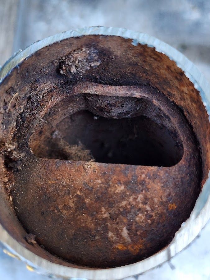

The weirdest thing - was when I cut the pipe - I looked into it and saw this.
Absolutely no idea of its purpose. Appears to be spot welded in place...
Hi @Noyade
Could be a support piece or custom fitting piece to hold the pipe in place? It definitely would have served some sort of purpose otherwise they would have installed it.

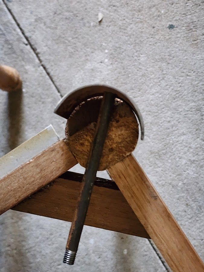

Proved a little tougher than I thought.
But got there in the end...
Re: How to fix loose table legs?
Hello @Noyade
Thank you very much for the update, those are fantastic D.I.Y supports.
