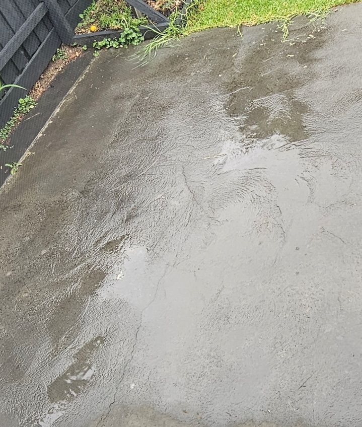

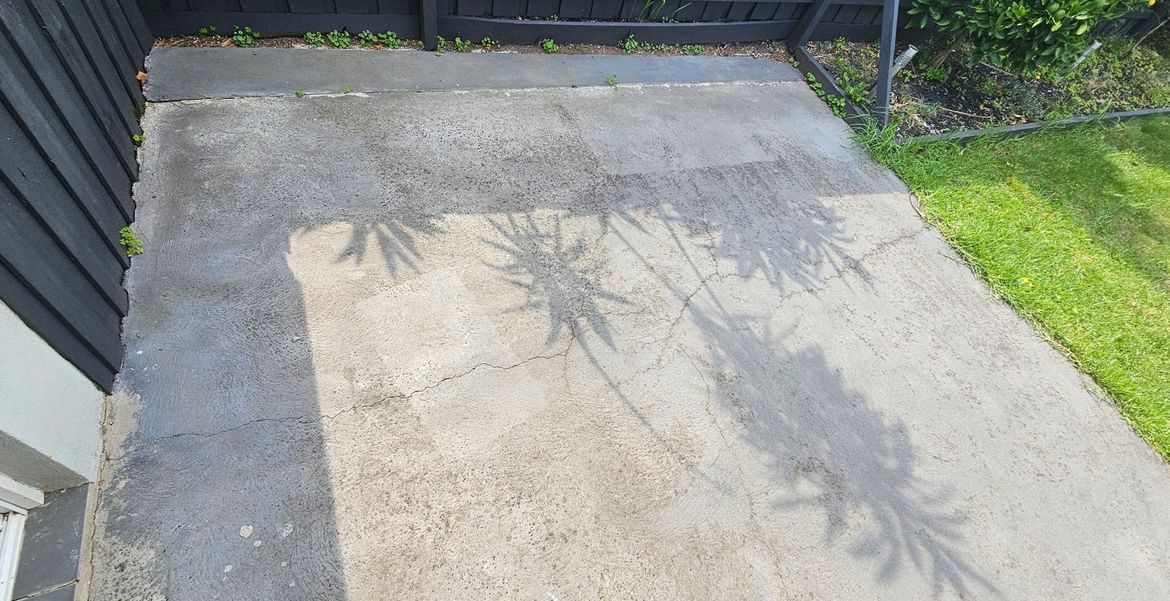

I'm trying to improve my front patio and I want to do a floor renovation.
As you can see in the photos the current floor doesn't look great, this is very old and the finishing wasn't great also every time it rains you can see water puddles. The size of the patio is 4.2m x 3.9m.

1.- Fix cracks, level the floor with self-levelling compound and after that add epoxy to improve the look or tiles.
2.- Fix cracks and add porcelain tiles directly without leveling the floor, I understand that should be fine if i back butter tiles adequately.

Floor_Front_Patio.jpgfloor after rainfloor after rain

I don't think filling the cracks separately is necessary — a self-levelling compound would typically take care of filling them as part of the process. However, looking at the amount of cracking and the general condition of the slab, it’s likely that the slab doesn’t have much (if any) reinforcing mesh in it, which is why it’s cracking and moving.
Because of that, I’d be cautious about laying tiles or epoxy directly over it. Both of those finishes rely on a stable, non-moving surface — if the slab continues to move, you’ll end up with cracked tiles or failed epoxy down the track. Even if you use a levelling compound first, you’re still working over a compromised base.
You’ve got a couple of options. One is to remove the existing slab and pour a new one with proper reinforcement, which would give you a long-lasting, stable surface for any finish you want. The other option is to lay pavers over the top of the existing slab. Pavers are a bit more forgiving if there’s minor movement underneath, and if you prepare the surface properly, they can handle small imperfections much better than tiles or epoxy.
I know that’s probably a bit more work than you were hoping for, but it’ll save you a lot of trouble later.

In terms of cost @jnk2025 , it will really depend on a few things like how much demolition is needed, what thickness and finish you want for the new slab, and access for machinery. For a small area like yours (around 16.4m²), it's definitely a manageable size job, but prices can vary a lot depending on where you are and whether you're doing any of the work yourself (like demolition). It’s worth getting a few quotes to compare — sometimes smaller concreters are happy to take on a job like this without it costing a fortune.
As for the weather, yes, the cold and rain can definitely have an impact. Concrete needs to cure properly to get its full strength, and heavy rain while it’s curing can weaken it or mark the surface. Cold weather can slow down the curing time too, which isn't necessarily bad, but it means you’ll need to plan carefully. Ideally, you’d want a few dry days for the pour and the early curing period. A good concreter will work around this and might suggest waiting for a better window if needed.
