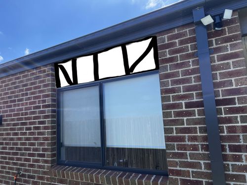

apologies, I have attached a photo of the window infills as stipulated in my original post
A Gabion wall panel would def look good I’ll have to investigate how they’re installed
trying to visualise how Tudor type panels would look in these infills

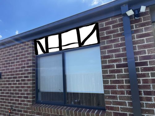

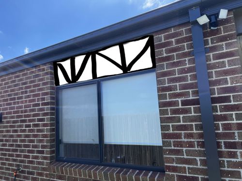

Afternoon @Grav
Here are a few ideas of what I mean by tudor styling. Its just black painted trim really to "fake" the look
Above your garage you could do the same. For the trim maybe
66 x 42mm 2.4m f7 h3 treated pine primed losp 2.4m
or check out the various sizes for external trim
external mouldings
Id suggest to use a drop saw to cut the angles :smile: and It is easy to do (I was nervous as the first time I tried to get it right) and then either liquid nail or tack it with bullet head nails depending on what material it is to the sheeting that is there. (You may be able to find teh studs behind that grey board if you are lucky)
