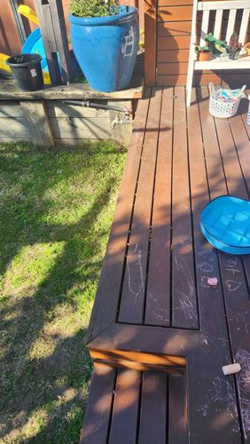

(Please excuse the state of our decking!) The previous owners of our house installed a small decking outside the back doors of our house but there is no balustrade. I'm keen to install one as I have kids. Am I able to diy this? And please could you advise what is best to use

Looking at the photo, it appears the deck is at a height that didn't require any balustrade. Building one that includes a gate can be quite involved and not particularly an easy or cheap exercise either as @EricL has very well laid out.
So, the first thing to decide on is if you want a permeant or temporary one? If permanent, do you have the skillset and tools required or do you get quotes from builders or handyman services. Aluminium ones over timber are much easier to DIY build. This range from Bunnings makes it very easy. They can be easily installed using posts.
The 5th row of decking boards from the end will need to be removed and where there will be posts fixed above, the joists will need a double up. Then the boards back down ready for the posts to be screwed to.
And if a temporary solution is required, what are your options?
If your children are only toddlers, then you can buy both new and second hand ones that could be placed near the house opening of the deck restricting how far the kids can access the deck with a gate for the adults. These could be fastened to the deck to make them more secure, but would leave holes once removed.
2nd hand pool fencing, especially non-glass type aluminium is a dime a dozen on and very cheap. this includes safety gates as well.
This 2nd option I have done many times for people. 3 weeks ago I just removed some as the customer was upgrading their pool areas. And last summer a mate bought 12 2nd hand glass balustrade worth a few thousand dollars for $250. Albeit random sizes, we made it work. We just needed to strengthen the deck and buy the securing pillars, which was another $120. With aluminium balustrade you have the easier option of being able to cut it perfectly to length.

I was looking at your photo and re-reading what you are after. If you are after just a handrail to stop the kids from being able to go over the edge of the deck in the photo I wonder if this idea would work?
Three new posts on the outside edge of the deck, one near the steps, one in the middle, one at the far end. Into concreted footings (holes 600mm deep)
The posts are connected to the deck via bolts through the posts (plus washers) into the deck substructure. As the deck is under the 800mm odd height it dosnt need a handrail but it would be wiser to have it there.
