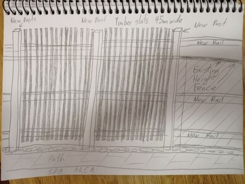

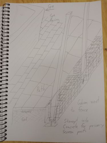

Good Afternoon @HandyishChick
I am always a little hesitant about adding weight to the top of an existing fence, mostly because the posts that carry the load are installed correctly for the existing load of the fence, raising it height brings a bunch of other factors into it.
As a work around you could install some new timber posts half way between the steel ones (no issues with compromnising the footings) and then you could install the extra 600mm height you want with no issues. You could then stay with the slats that you want.
I had the same issue with my fence, the old neighbours rmoved their bushes and bingo the area was nice and open :smile: So I am going down the route of seperate post sto extend the height of my privacy screen.
Existing fence
New fence, have modified it mostly due to cost. And am only going to install horizontal slats the top 600mm ish with a narrow bench halfway up.
I have minimal space to install footings, you have the space accesable so it should be easy to install some new posts next to your rails.
