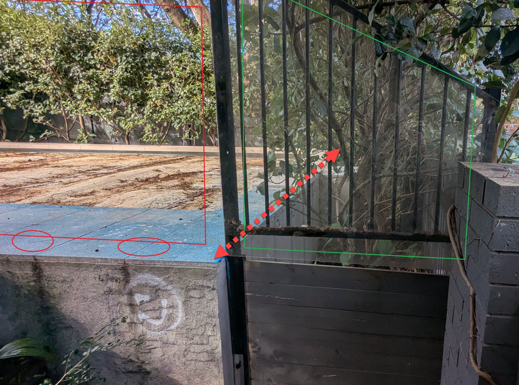

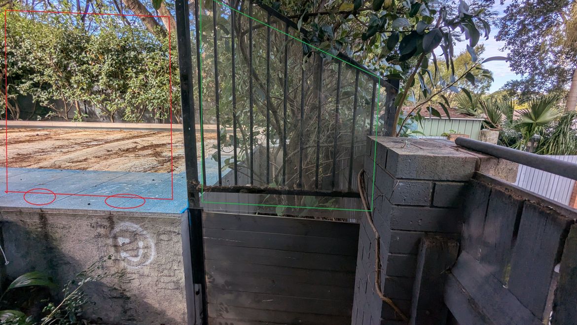

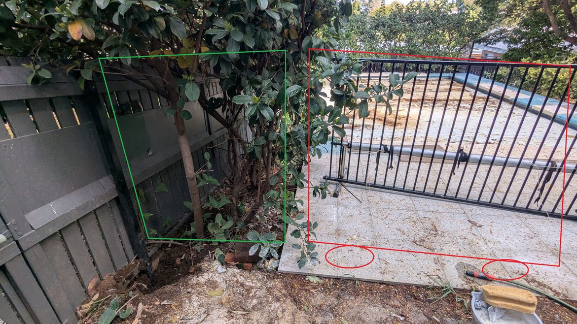

i have a question please about fencing around my pool - i used to have an aluminium fence which i took out and i m now planning to replace with glass panels - there are 2 sections where the aluminium fence was going over 2 garden beds (as per photos 1 and 2) to completely block the access and down to the ground .
on one section one can see it was being held by one aluminium post to the left near the neighbour fence which was simply screwed to the neighbour fence and on the other side it was held by another alumimium post which was sitting on the pool tile and i have now taken out (as i m also re-tiling) .
on the other section the fence was being held on a post on the pool side which was screwed to the side of the pool on one side and again to the neighbour fence on the other
In both cases the aluminium post to not have a concrete base and are simply screwed no each side which was probably ok to support a light aluminium fence . Now i m wondering what would be the best way to replace these 2 sections with 2 glass panels knowing that these are quite heavy and may not be the best idea to simply hold them on the sides with friction clamps . I m assuming spigots underneath would be a must but i m unsure how this can work out with current terrain and i wasn't planning on concreting this section either
any idea/suggestion most welcome!!
photo 1
photo 2

Thank you jacob. The edge you are pointing out is at a height if 50cms from ground howvever i should have added that there was an aluminium fence there before that we took out as we are re tiling the pool and take that opportunity to add a glass fence instead. Pool was fully conpliant and certified before we would just replace the aluminium section around the pool with glass panels but we were unsure on best way to proceed with the 2 highlighted sections and how best to support glass panels there.....or is it best to stick with aluminium fence as it is today and not to touch it as it s much lighter than glass...

With your photo1 I would be actually installing a concrete footing for the posts and coping along the area under the fence to a resonable depth so it cant be dug out.
The pool was compliant with what was there before, replacing/changing it means that any new addition to rules will have to be accomodated for. So something that was ok before may not be ok in that same configuration. Your local council will ahve the specifications on their website (just in case you dont know) ![]()
