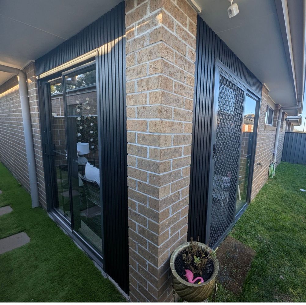

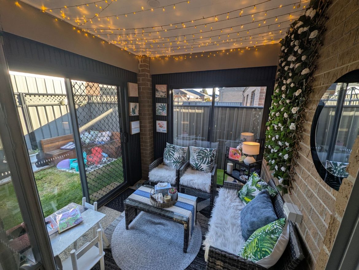

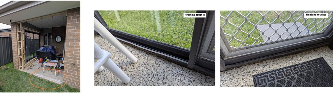

I ended up using an angle grinder to level out a patch of concrete, giving it a near-perfect base, as shown in the photos below.
I’m still exploring options to finish off the exposed base on both the inside and outside—possibly with angled trims as cover plates. I’m open to any suggestions or alternative ideas.
Below are some progress photos of this project. It’s not 100% complete yet, and I’ve already moved on to a couple of other projects around the house.
DIY project alfresco.jpg PXL_20250810_224142438.MP.jpg PXL_20250810_224154356.jpg PXL_20250810_225108924.jpg
