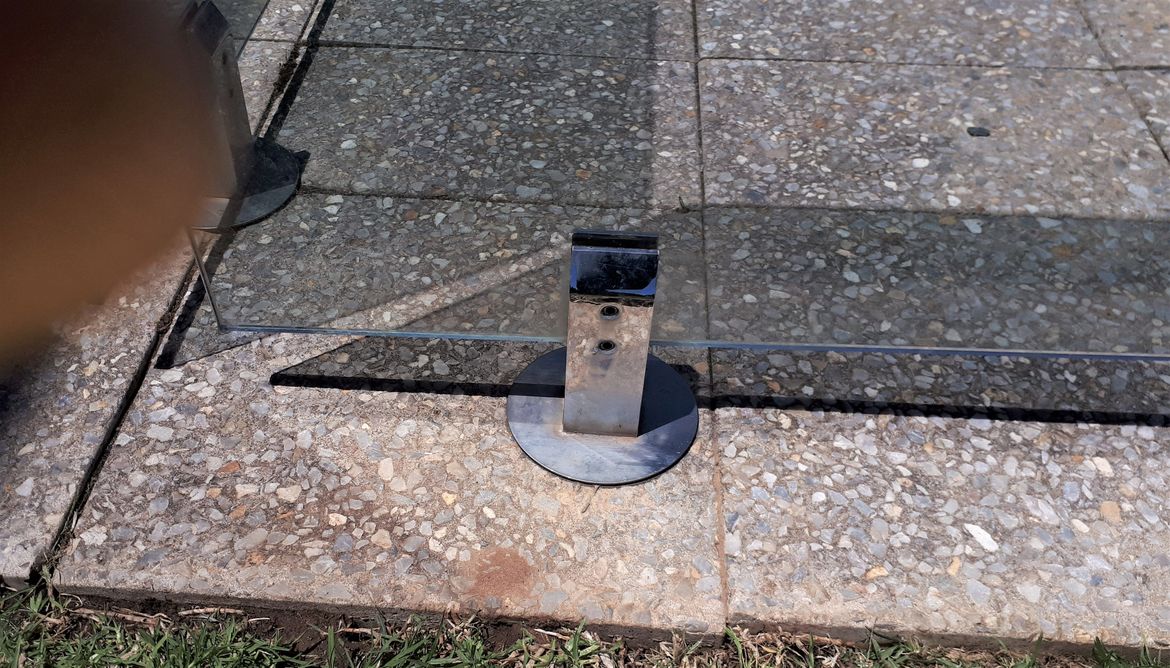

Photo attached below. Basically the ground has dropped by about 10mm and the rough plan is to lift the glass level. The issue is, the screws are loose but we can't move the glass. Any ideas on how to free it ?
Thank you very much for posting that picture of the spigot. I suggest using WD-40 275g Multi-Use Smart Straw to lubricate the joint between the rubber and the glass. However, please keep in mind that both sides must be removed and the glass panel must be taken off so that the rubber and the glass can be washed with soap and water. The WD40 must be washed off otherwise the glass will slip down again.
If the glass panel is still stuck despite using the WD40, I'm afraid it's time to call in a glass pool panel specialist. They will probably have tools and methods that will allow them to remove the pinched glass.
Let me call on our experienced members @TedBear and @JoeAzza for their recommendations.
Hi @ADV, I agree with EricL's suggestions for separating glass from spigot.

It's possibly not the rubber holding the panel in but the compression plate squeezing it. Have you removed those screws entirely? The rubber and panel should be easily removed when the screws are not compressing the internal plate. In fact, until you start tightening the screws, the rubber and panel loosely sit inside the spigot. Even if the rubber has bound to the glass surface, it should come out with the panel with no problems.
There's also a good chance that the internal compression plate has rusted in place, and even though you've backed the screws out, the plate can't retract into its recess. Have a look at this video on installing a glass pool panel to see what I mean. I don't think any of this information will probably help tremendously, but it might give you some avenues to explore. The first would be removing those screws completely to ensure they are not inhibiting the plate's retraction.

No luck yet. Tried the fishing line and it catches at the height of the first screw, almost as if there's something in there. I pushed a sharp thin knife down the spigot and it hit the same thing at the same height.
Hi @ADV
I suggest getting an extra pair of hands to hold the glass up from the bottom while trying to do the fishing line technique. I suspect that the spot you're hitting is the holding point of the glass. It might be necessary to relieve the pressure being exerted on it by having an extra pair of hands. I propose doing a combination of the WD40 and fishing line to make the line pass through easily between the spigot and the glass panel.
If you need further assistance, please let us know,
I suggest checking for the possibility of a protective sleeve running through the spigot and the glass.
If so, you'll need to make or find a wooden punch at the right diameter to push it out.
