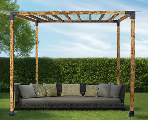

I have a Pargolas similiar to this.
I want to put a roof on it.
Do you recommand to use the flat roof https://www.bunnings.com.au/sunlite-10mm-twinwall-x-3-0m-clear-polycarbonate-roofing_p1010590 or this one https://www.bunnings.com.au/suntuf-trimdek-3m-solar-grey-polycarbonate-roofing-sheet_p1010785 or corrugated roof https://www.bunnings.com.au/suntuf-1800-x-660-x-16-beige-cooltop-corrugated-1800mm_p0037610 ?
The top part of my parlago are flat. I need to make a slope for the roof. I am thinking to put the Batons https://www.bunnings.com.au/42-x-42mm-5-4m-baluster-handrail-h3-pink-pine-fj-primed-losp_p0052850?pr... but they are all same size. Do I need to sand them to get different height?
Thanks.

Adding a roof to a pergola significantly alters the structure's dynamics, and it’s important to ensure that the pergola can safely handle the additional weight and wind loads. Many prefabricated pergolas are not engineered to support roofs unless explicitly designed for that purpose. Adding a roof without verifying the structure’s capacity could compromise its integrity, especially in high winds. To ensure safety, it’s recommended to consult with a structural engineer or professional before proceeding.
If your pergola is suitable for a roof, polycarbonate sheets are an excellent choice due to their lightweight and durable properties. The Sunlite Twinwall sheets provide a modern aesthetic and good thermal insulation, but they require sturdy framing due to their flexibility. The Trimdek sheets offer a flat, sleek design that’s easy to install and provides UV protection. Alternatively, the Corrugated sheets are lightweight and effective at dispersing water, making them ideal for sloped roofs.
Using treated timber battens to create the necessary slope is a practical approach. However, instead of sanding them to different heights, consider elevating the high end to create a slope down to the low end. Ensure the slope is at least 5 degrees (a 1:12 pitch) to allow proper water runoff. For added durability, secure the battens with corrosion-resistant fixings and ensure the roof sheets are installed according to the manufacturer’s guidelines.

I am sorry. Does it mean I lift up one side? put some wood underneath one side?

I watched the video twice and there was no picture of a slope in the guide. It could be included in the kit she purchased. For your project I suggest following Mitchell's advice and elevating the high end to create a slope down to the low end. Ensure the slope is at least 5 degrees (a 1:12 pitch) to allow proper water runoff.

Have you read the spec sheet from the company that says its ok for a roof to be added? I know the brackets look solid and fastening down to concrete in the ground looks good but when a roof is added to a structure think of it as an umbrella or a trampoline in the wind.
As @MitchellMc has said pollycarbonite sheets are light, tho still act as an umbrella in regards to "lift" in a storm situation. My pool deck has multiple attachment points and it still I think of it in wind gusts. (you can look at my bookmarks and see the decking projects)
With the fall you are after, think of a 70mm by 35mm picee of timber looking end on. This is placed on top right under your eve standing up (so its 70mm tall) then the middle slat will be placed lying down so its 35mm high, then there is no slat on the lowest side (near the fence)
This way water will have a slow fall away from the house. I am presuming you have installed all four posts at equal levels and into aq solid deep concrete footing. Oh just a thought, you cant have water fall next tour fence with no guttering. You will need guttering and a downpipe plus factor in where you will funnel the stormwater to travel to.

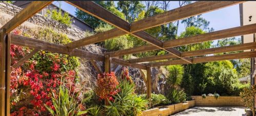

Hello. I have a similar project. Just wondering how you recommend to attach the new purlins to the existing pergola? I have attached a photo of my flat roof pergola. I plan to put some clear sheets with a gentle slope and was advised to add new purlins in a similar way to what you have suggested. I’m wondering though, instead of different height timber to create the slope, could I instead use steel brackets and create the slope by using different height brackets?
Good Afternoon @asmithdigital
Mmmm Think we need some more information about spans and how that center is supported first before I would recomend adding weight to the pergolla.
- I cant see how the center span is supported from your photo, plus how the timber comes off it. I can see bolts but not sure how they have been attached to the center.
- Is the top of the pergolla level?
- The span from the wall to the posts, is the center span in the actual center. The posts distances between each other.
With your suggestion of steel brackets to adjust the height of the slope I would say it will be a lot harder to do then adding a length of timber to the top side. Taking a guess I do think you will need to add strength to the structure to allow the sheets you want to be fixed securely. At least every quarter across the width of your existing roof.

In regards to your question of purlins, again, it would be best to consult with an engineer as they will be able to analyse your current structure and give you sound advice in regards to what needs to be modified in order for the purlins and the clear sheets to be properly supported. As to the angle brackets, I agree with @Dave-1's analysis and that it will be a great deal more difficult to attach and adjust.

The joists run full width from left to right in the image. Just to the right of this image is the brick house where the joists are attached to the ledger board which is attached directly to the brick. The timber running along the centre (front to back of the image) are attached with big screws. I plan to add very light weight sheets just to cover from rain. Yes it’s very level and strong. My question is really what steel brackets could be used to bolt directly onto the joists, and attach new purlins. I assume I would need to add more structural support and joists as well to ensure it is secure for wind etc. I appreciate your advice.
Thanks Eric
I completely agree. This isn’t prefabricated, it’s custom built with heavy duty bolts and hard wood. I have consulted my roof plumber brother and he recommended adding purlins etc, I’m just looking for advice on whether I should take a similar approach as the OP Michael, by adding different height purlins to achieve a gentle slope, or whether there are steel brackets I could use, at different heights, which would allow me to achieve a gentle slope but with the same dimension purlins.
