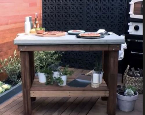

Hi all. I’m looking to build something similar to the concrete and timber table featured in one of the Bunnings inspiration vids but am concerned about matching the legs (DAR post) to the frame as all colours appear slightly different online. Should I just be using the decking planks?

It is not particularly obvious in the picture you have supplied but the timber they have used in the project is indeed different colours. Those decking slats used for the shelf are much lighter than the DAR posts. This was even more evident in Step 22 before they stained the timber. I've included a picture below which shows the difference.
To ensure a close colour match of all the timbers I would encourage you to use a stain with a colourant added instead of the natural stain used in the tutorial. A product like Cabot's 1L Water Based Merbau Garden Furniture Oil would be suitable. You might like to give the lighter coloured decking timber two coats and the DAR posts only one.
