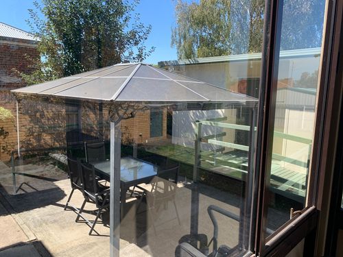

Can I do that on my gazebo
Welcome to the Bunnings Workshop community @flussy. It's brilliant to have you join us, and many thanks for your question about painting a gazebo.
Let me mention @DIYMum to get their thoughts.
What is your gazebo made from? If it's plastic, a similar approach would likely work, but if it's a different material, if you can provide details, we can work out the best method.
