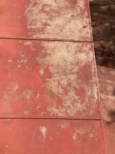

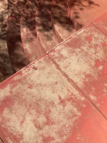

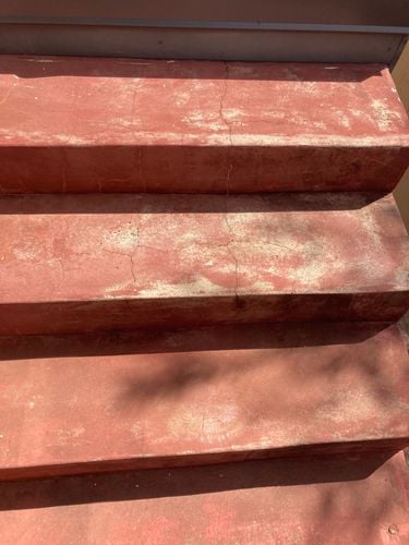

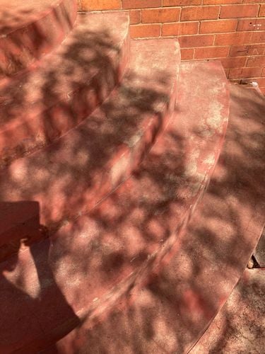

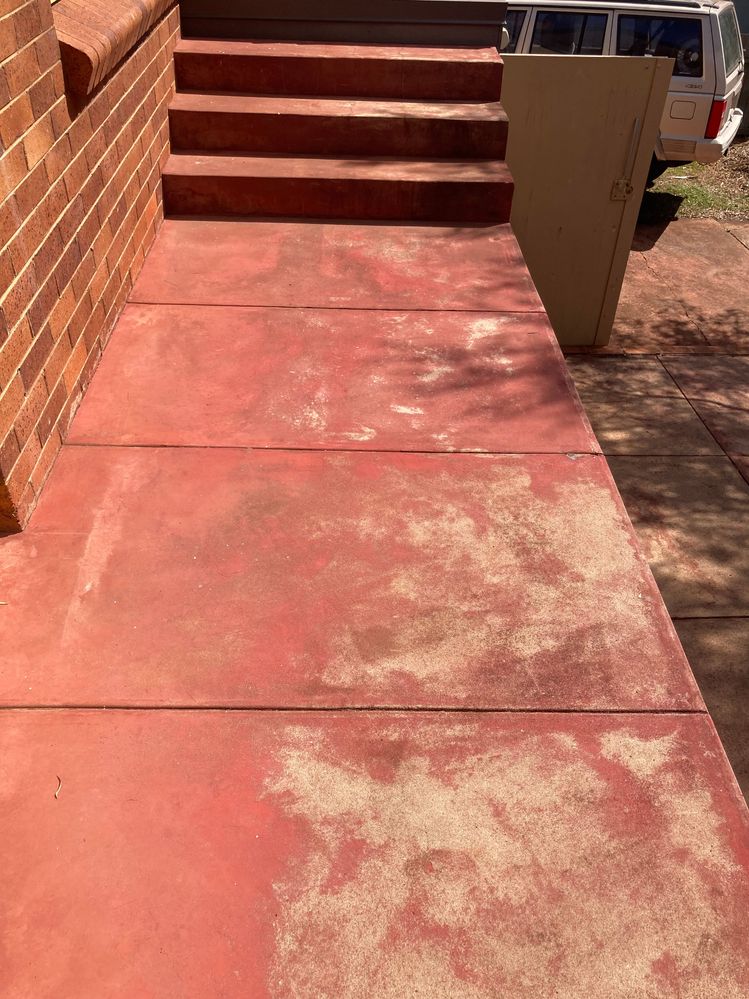

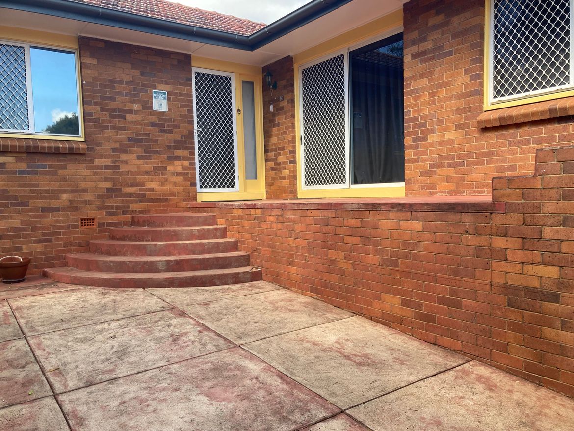

My house is on a sloping block that (face on) lowers from left to right nd back to front.
The front door opens onto a brick porch with concrete surface
The porch is approximately 1 metre high at the door end and 1.2m high at the other, with 3 steps leading up at the end to the roof of the garage, which used to be a deck but is now just roof.
The porch is approximately 1.5 metres wide by about 4 metres long + about a metre for the steps.
The house is about 55 years old and I believe that the porch is original and the paint on the concrete just as old. - In places there is virtually bare concrete but there are also areas where the paint seems relatively sound.
I don't want to acid etch if I can avoid it but neither do I want to do the job only to have the paint peel later. However, as I have this mix of painted, reasonably smooth, (though thin) concrete patches with other rough bare concrete I'm not sure what to do.
Should I attempt to etch just the painted parts?
Is there a primer that I could simply put over the whole area?
Is there a coloured sealer that I could put over the whole area?
Any advice as to the best way to go, I would greatly appreciate.

It basically comes down to you having degraded paint on the surface. Apart from the Rustoleum, including their re-coat primer, I'm unaware of any other paints that can be warranted over a compromised or deteriorated surface. Using the re-coat primer is important as it's designed for coating over degraded surfaces. If you didn't use the primer, their topcoat is the same as any other manufacturer and not designed to adhere to deteriorated surfaces. If you speak with most manufacturers, they'll suggest you need to coat over a sound previously painted surface or if the existing coating is degraded, remove it completely.
If you can live with the Rustoleum Battleship/Armour grey, I'd recommend going that route.

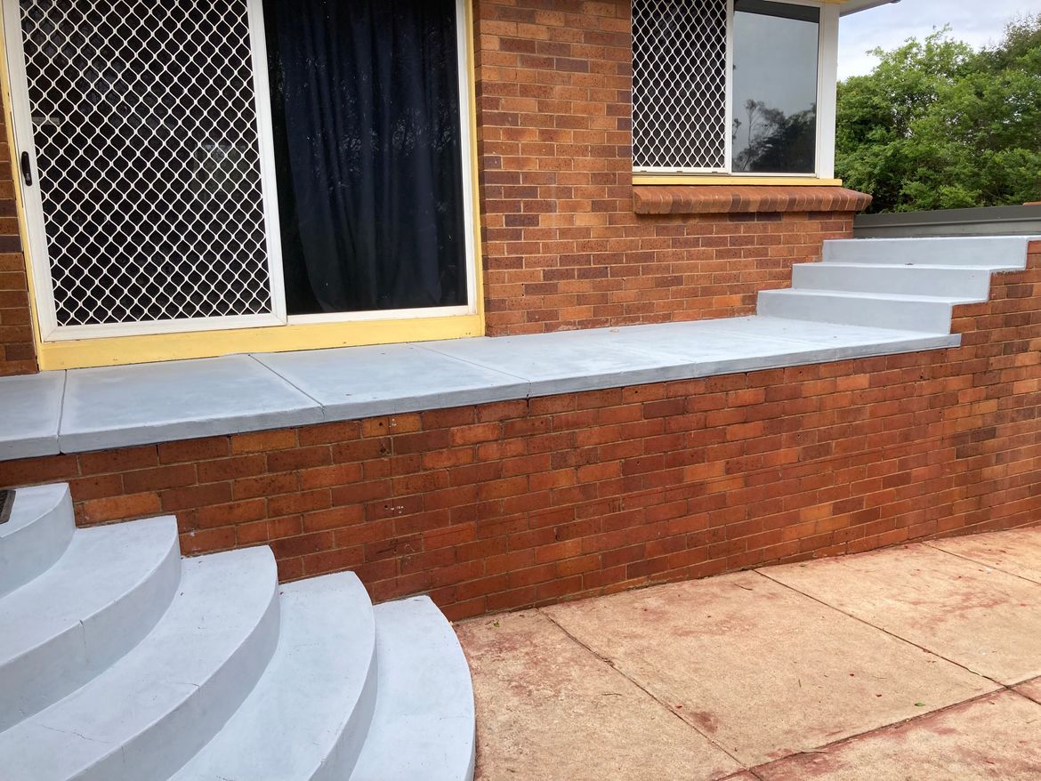

I've just completed the job using the Rustoleum products suggested by Mitchell and Jason but wish to thank all who responded for your comments and suggestions. I appreciate all the input made.
Attached are a couple of before and after photos. Unfortunately, I didn't think to take photos after the primer stage and now regret that because it was much darker in colour and, in fact, I was pleasantly surprised and would have preferred the finishing coat to be darker. It certainly doesn't correspond with the label on the tin but I guess that's always a potential problem with colour printing.
I found the process fairly straightforward and the primer and paint both fairly readily applied, though the usage per m2 seemed higher than I would have expected, perhaps because of the state of a lot of the concrete. That may also explain why there are 'shadow' patches in places where the concrete was most worn. One coat is certainly not really sufficient there but as I am also building a fence for safety against the drop, I will probably wait until that's finished and then recoat just the worst patches and fix up any accidental marks or whatever from the fence construction at the same time.
The job is reasonable, I think, for an absolute amateur with no trade skills or experience. At the same time, I wouldn't take offence or be surprised if anyone scoffed at or derided it - I claim no expertise but my very limited resources mean that I have to do 'as needs want' or whatever that old adage is.

As it was
As it is now ...
Hello @nonsibicunctis
Thank you very much for your update, your newly painted concrete porch looks excellent. As far as first attempts go your paint job looks very good.
We look forward to seeing the next part of your project.
Morning @nonsibicunctis
Id be very happy with that! Wierdest thing is its the same colour as my patio taht I just painted! lol Do you walk out on it and stand there and just "nod your head"?
Looks good and lifts the area into being cared for again ![]()
