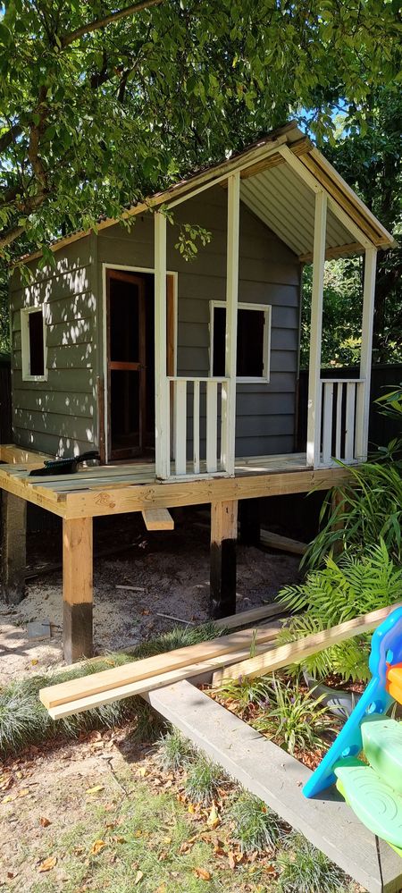

Some pictures for your to see my progress.  A few errors and struggles along the way. Lots of tree roots meant digging the holes wasn't too easy. Errors in the base isn't 100% square but I managed to get it to work.

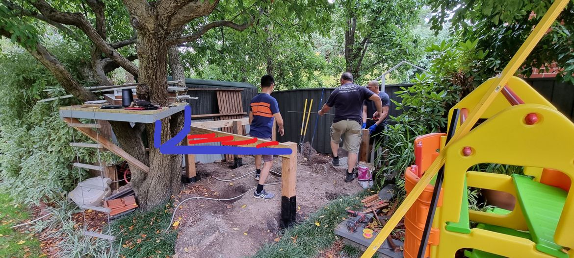

One question I wanted to extend the verandah to connect to the tree and the landing that is already on the tree. What I had in mind was to triangulate the verandah and create a step up to the landing on the tree.
Have a look at my concept diagram and let me know if you agree with this idea.

Oh, wow @globetrotter! Amazing effort! That's looking wonderful.
We might no longer be friends, but I'd like to see an additional post installed for your triangular verandah. However, it should be fine if that corner can be fixed adequately to the frame above.
I can't wait to see this finished; it's a very inspiring project. Please keep us updated.

I think I'm over digging post holes :-). I'll connect a post from the frame above to the new verandah.
