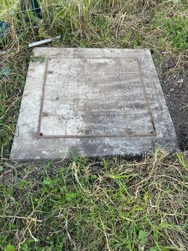

Council said it’s my asset and we can do what we want to it as long as they can get to it if need to I’ve asked about raising it and putting a top on it then cover a little with soul and then put a back shed on it they said that’s fine as long as they can get to it my question is what’s the best material to use corner post and sleepers I thought but a little bit expensive I’m thinking some kind of board screw it together like a box with lid on top what do you guys think and what’s your recommendations ? Need all the help with this thanks guys Mario
sorry I forgot to mention I’ll be raising the back yard by about 800mm high to make it level there will be retaining walls around boundary fence line that’s the reason to raise the storm water maintenance pit thanks

My apologies for the late reply. It's great that the council's only condition for the maintenance pit is the ability to access it. I suggest making a timber tunnel to go around the cement pit's edge. The condition of the build is that there must be enough room to get the cement cover out should you need to access the maintenance pit.
I suggest using 200 x 50mm x 3m Hyne Timber Pine Sleeper as the tunnel's main body. Depending on the size of the actual pit, I approximate that you will need at least 3 lengths to make the tunnel and the cover. I recommend using Selleys 350g Heavy Duty Liquid Nails to join them together and using Zenith 14G x 100mm Galvanised Type 17 Batten Bugle Head Timber Screws - 25 Pack N to prevent them from shifting.
You may use your preferred method of anchoring the tunnel to the top of the pit. The tunnel can be buried and is strong enough to be surrounded by soil. Please have a look at the suggested sketch and tell us what you think.

Hi Eric sorry I forgot to put in the dimensions for the storm water pit its 1300 mm all around thanks Mario

Thanks Eric awesome info great job thanks dimensions all around storm water pit is 1300mm and height 750mm thanks Mario
