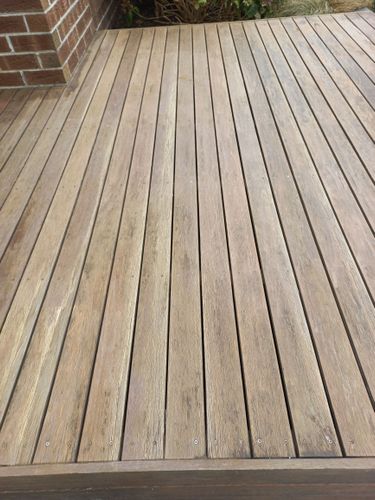

Nearly finished. A little bit more on Monday, then oiling. It's a lot of hard work, but we're getting there.
Re: Black mold on decking
Great work @ChrisNoor! That's looking much better.

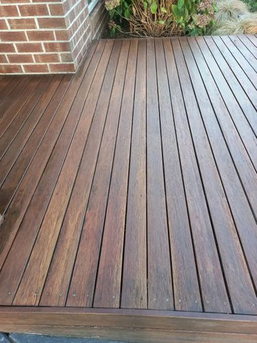

Finally, after having some rain for two days on end, I got to oiling it
today. Two coats.
Its OK, but I can still see quite a few mold spots. Oh well. Looks like it may need to be done again next year.
Heaps better than it was though.
Re: How to remove black mould on decking?
I think it's come up great @ChrisNoor. The main portion of it looks fantastic. There's a bit of residual previous coating around the wall and pillar that you could sand back next year, though I understand it's quite hard work.
I think you've done a marvellous job.
