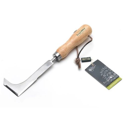

I use a paver weed remover tool
In conjunction with a regular weeding tool and... sit on a kids stool.
Kind of like doing a therapy session 😊
