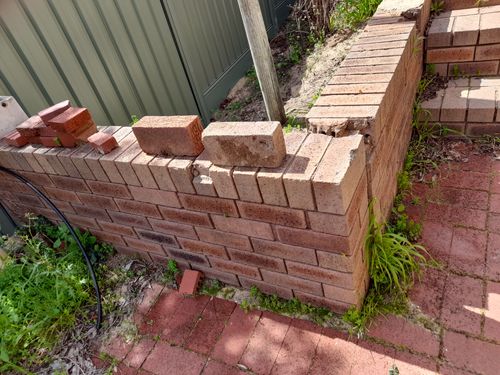

I need to use some bricks from an old fence so that can be used to do some brickwork on our house as the same brick is no longer made. I am finding it really hard going to remove the bricks as the mortar is super strong.
Is there any electric tool that can slice through the mortar?
Hi @ennoh,
There are methods using power tools such as an angle grinder with a diamond blade or a reciprocating saw with a diamond grit reciprocating saw blade, but they will create airborne dust, which is harmful if inhaled.
If you are aware of this and take the necessary precautions, such as wearing a P2 respirator or better and wetting the mortar to reduce the dust, then it can help to speed things up greatly.
If you use this method, please also be aware that angle grinders and reciprocating saws are loud and they can kick, so wear gloves, long protective clothing, eye protection and hearing protection to protect yourself.
You could also use a hammer drill with a masonry bit to drill out a series of holes in the mortar, then use a hammer and cold chisel to further fracture the mortar and allow for easier removal.

I have finished reclaiming the bricks and demolishing a small wall. The Ozito Hammer drill with a chisel was a great help. For just under $100 it was great value and it removed the need to bang away the bricks with a chisel and mallet. It was still hard work because the mortar was so strong but my son and I managed to reclaim sufficient bricks for the brickies to use on Monday.
