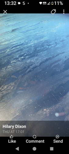

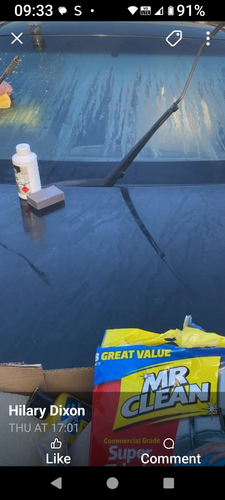

Yes I have had a vandal
 Pour  apparantly epoxy resin down across my front windscreen on my car
  A be Commodore Calais type
  It was very thick on finding this the same night
It was vandalled
  Upon going to Bunnings this store and reco the following day
  In one day I was sold acidtone from Bunnings for this  and from Repco  I was sold stuff off on a can for this
 Both I had specifically explained myself what I was needing to use to remove this to the rep workers
   Firstly this day  I get home and apply acidtone to windscreen  as directed
Left for period of time. As directed   wiped. Did some scraping
   Etc.
  Hours later after this
Yes it seemed to had thinned the apparant eprixy resin  somewhat
 The day after this   as still was not removing this leftover. Epoxy resin substance
 I tried the stuff off can. As reco suggested
 This was again  did as directed
 This also  did I'm unsure what. But. Made it appears slightly sticky
   Tryed scraping  etc. Wetting wiping
  No it's still on windscreen
 Hard to see driving
 The oy thing I found myself  is I bought a hand held steamer cleaner  from Kmart  1 day ago. After the above methods have not worked
    Also tryed with a heat gun removal but no
  Not at all did nothing
   Wuch the steamer. Yes started to. Completely remove on both sides of the entire windscreen downwards. Approx  a foot on driver side and passenger side
  Near completely removed this eproxy resin
substance   but. Not still NOWARE near  a clear windscreen. I'm wanting desperately some advice or how to remove this. Thankyou
