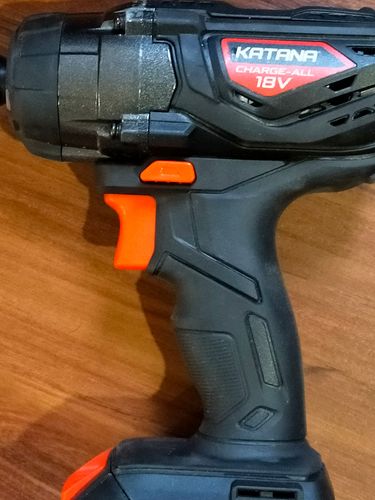

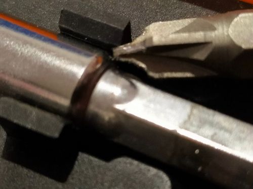

Hi All,
   I was trying to drill the screw into the fence and got snapped half way through. I'm using impact driver with craftright screwdriver bit. The screwdriver bit got snapped. Not sure if it is underpower of the impact driver or the bit itself or both. Should impact wrench does the job? Any advise? 

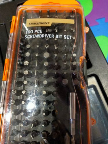

Hi @calccom21,
Provided that you are using the correct sized bit for the screw and putting adequate pressure on the drill, the bit might have been destroyed due to it being very budget-friendly. Those kits are ideal for use in low-torque applications and provide a heap of different bit styles for all occasions for minimal cost. However, impact drivers have a lot of torque, and I feel you'd be better off picking up an Irwin Impact Pro Performance 57mm PH2. These singular bits are far superior to the budget-friendly options and designed for use in impact drivers. With correct use, they won't shear the drive tip wings off.
Impact drills can do your job, but they are a little harder to control than a drill driver.

Re: How to repair a fence?
Thanks - i went and get the irwin impact pro 57mm PH2 - i was very impressed with it. It drill into it smoothly. Glad that i do not need a higher torque driver
