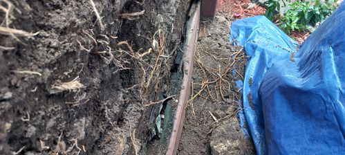

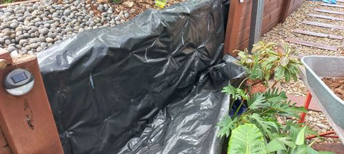

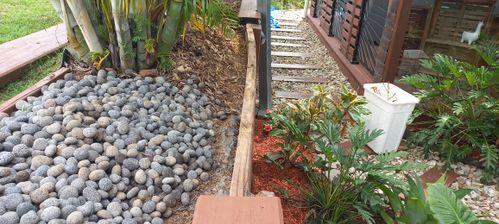

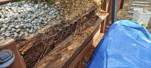

Thought I'd update with progress. I've successfully replaced the sleepers in this section after some challenges along the way.
Initially I was hoping to only replace the bottom sleeper but it became evident very quickly that all would need replacing as you'll see in the images.
The combination of roots and moisture made short work of each sleeper but the silver lining was that scrapping them made disassembly a lot easier. I was able to saw down each side to pull them out then using a reciprocating saw, shear the bolts holding the ends in to pull them out.
The largest challenge I faced was that the soil had deformed the sleepers and it was bowed so heavily I had to grade two wheel barrows worth of soil to make it square again for the incoming sleepers. Very painful!
Once done I repacked the agg pipe at the botto with gravel and placed plastic over the top. I hope a combination of this and the heavy painting will help combat future rot better.
Thanks again for the advice, certainly made the process easier.
Only 8 sections remaining....
