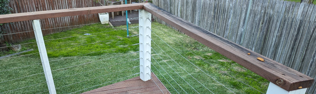

My house had a deck when I purchased it which was built in 2017.
One of the railings began growing fungus a few months ago, and has become rotten and discolored (can easily stick a screw driver into the wood).
The railing adjacent and the supporting posts do not appear to be affected:
I removed the railing today and will give the top of the posts some time to dry out, before I seal them and replace the railing.
I have some questions about the replacement:
- What could have caused this railing to rot, while all other railings are fine?
- This railing had 4 bugle screws in the top driven into the posts, in addition to the metal brackets underneath - why would the screws also be installed? Most other railings do not have bugle screws, and these appear to have allowed water to penetrate the treated wood more easily (the bugle screws are rusted). The only purpose I can think of is to try to prevent movement since the railing is mitered on one side? Should I use bugle screws again on the replacement or just accept the miter will separate outside anyway?
