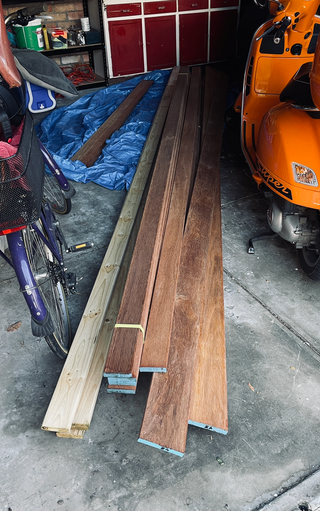

I have finally got round to buying all the timber and decking I need to start this project.
The shop where I bought the wood from mentioned it would be good to finish the decking off properly by creating a border, so I have bought the wood for those too. Appreciate your advice on if any of the steps you've mentioned already, for laying on to tiles, needs to change based on the border.

It doesn't look like the steps would change @mrpatel. I'd suggest the border timber will be affixed vertically to the front face of the landing area. That will finish the deck off nicely and cover the exposed ends of the decking boards.
Was that all the decking timber? There doesn't appear to be much in the photo. Also, what were you using the treated pine decking for?

The decking timber is not long enough to go flush to the ends, I bought the desired length of decking to allow for a border on the top.
I do want to conceal the concrete though, so maybe I will need to buy more timber for that.
The treated pine is what the staff at the timber shop recommended for the joists.
